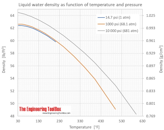

The density of water depends on temperature and pressure as shown below:
See also other properties of Water at varying temperature and pressure : Boiling points at high pressure, Boiling points at vacuum pressure, Dynamic and kinematic viscosity, Enthalpy and entropy, Heat of vaporization, Ionization Constant, pKw, of normal and heavy water, Melting points at high pressure, Prandtl number, Properties at Gas-Liquid Equilibrium Conditions, Saturation pressure, Specific gravity, Specific heat (heat capacity), Specific volume, Thermal conductivity, Thermal diffusivity and Vapour pressure at gas-liquid equilibrium .
For other substances, see density and specific weight of acetone, air, ammonia, argon, benzene, butane, carbon dioxide, carbon monoxide, ethane, ethanol, ethylene, helium, hydrogen, methane, methanol, nitrogen, oxygen, pentane, propane and toluene .
Density of crude oil , Density of fuel oils , Density of lubricating oil and Density of jet fuel as function of temperature.

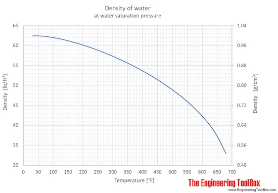

As shown in the figures, the change in density is not linear with temperature - this means that the volumetric expansion coefficient for water is not constant over the temperature range.
Water density, specific weight and thermal expansion coefficient at temperatures given in degree Celcius:

| 0.0 | 32 | 1.033 | 1033 | 2.004 | 64.5 | 8.62 | 64.5 | 10.13 |
| 4.4 | 40 | 1.032 | 1032 | 2.003 | 64.4 | 8.61 | 64.4 | 10.12 |
| 10.0 | 50 | 1.031 | 1031 | 2.000 | 64.4 | 8.60 | 64.4 | 10.11 |
| 15.6 | 60 | 1.029 | 1029 | 1.997 | 64.3 | 8.59 | 64.3 | 10.09 |
| 21.1 | 70 | 1.028 | 1028 | 1.994 | 64.1 | 8.58 | 64.1 | 10.08 |
| 26.7 | 80 | 1.026 | 1026 | 1.990 | 64.0 | 8.56 | 64.0 | 10.06 |
| 32.2 | 90 | 1.024 | 1024 | 1.986 | 63.9 | 8.54 | 63.9 | 10.04 |
| 37.8 | 100 | 1.021 | 1021 | 1.982 | 63.8 | 8.52 | 63.8 | 10.02 |
| 43.3 | 110 | 1.019 | 1019 | 1.977 | 63.6 | 8.51 | 63.6 | 9.99 |
| 48.9 | 120 | 1.017 | 1017 | 1.973 | 63.5 | 8.48 | 63.5 | 9.97 |
| 54.4 | 130 | 1.014 | 1014 | 1.968 | 63.3 | 8.46 | 63.3 | 9.94 |
| 60.0 | 140 | 1.011 | 1011 | 1.962 | 63.1 | 8.44 | 63.1 | 9.92 |
| 65.6 | 150 | 1.008 | 1008 | 1.957 | 63.0 | 8.42 | 63.0 | 9.89 |
| 71.1 | 160 | 1.005 | 1005 | 1.951 | 62.8 | 8.39 | 62.8 | 9.86 |
| 76.7 | 170 | 1.002 | 1002 | 1.945 | 62.6 | 8.37 | 62.6 | 9.83 |
| 82.2 | 180 | 0.999 | 999 | 1.939 | 62.4 | 8.34 | 62.4 | 9.80 |
| 87.8 | 190 | 0.996 | 996 | 1.932 | 62.2 | 8.31 | 62.2 | 9.77 |
| 93.3 | 200 | 0.992 | 992 | 1.926 | 62.0 | 8.28 | 62.0 | 9.73 |
| 121.1 | 250 | 0.974 | 974 | 1.890 | 60.8 | 8.13 | 60.8 | 9.55 |
| 148.9 | 300 | 0.953 | 953 | 1.849 | 59.5 | 7.95 | 59.5 | 9.35 |
| 176.7 | 350 | 0.930 | 930 | 1.805 | 58.1 | 7.76 | 58.1 | 9.12 |
| 204.4 | 400 | 0.905 | 905 | 1.756 | 56.5 | 7.55 | 56.5 | 8.88 |
| 260.0 | 500 | 0.847 | 847 | 1.643 | 52.9 | 7.07 | 52.9 | 8.31 |
| 315.6 | 600 | 0.774 | 774 | 1.501 | 48.3 | 6.46 | 48.3 | 7.59 |
Weight per U.S. gallon is based on 7.48 gallons per cubic foot .
