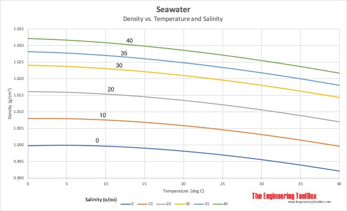

Density of Seawater vs. Temperature and Salinity
Density of seawater vs. temperature and salinity

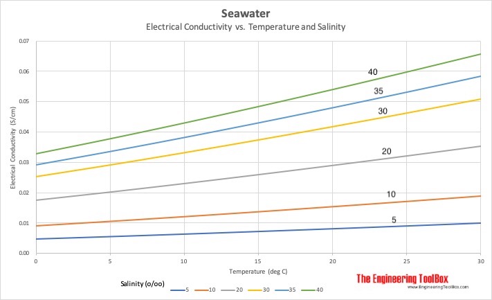

Electrical Conductivity of Seawater vs. Temperature and Salinity
Electrical conductivity of seawater vs. temperature and salinity

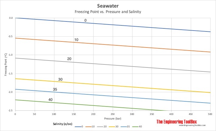

Freezing Point of Seawater vs. Pressure and Salinity
Freezing point of seawater vs. pressure and salinity
