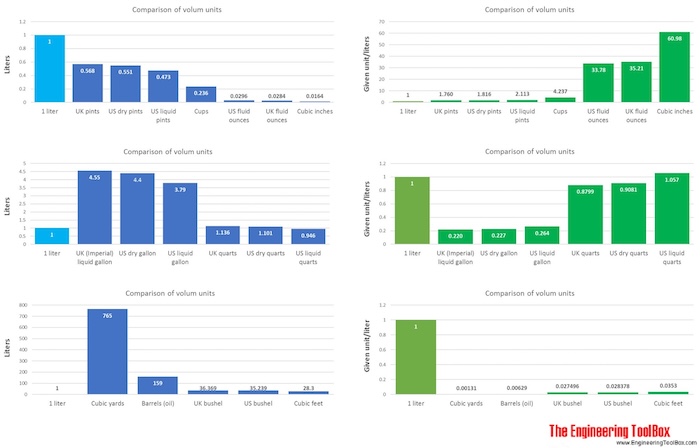

Volume converter
Other Volume Units
  • 1 m3 = 27.496 bushels (UK)
  • 1 m3 = 28.378 bushels (US)
  • 1 m3 = 0.001 cubic decameters
  • 1 m3 = 1759.8 pints (UK)
  • 1 m3 = 1816.2 pints dry (US)
  • 1 m3 = 2113.4 pints liquid (US)
  • 1 m3 = 879.9 quarts (UK)
  • 1 m3 = 908.1 quarts dry (US)
  • 1 m3 = 1056.7 quarts liquid (US)
  • 1 m3 = 67628 table spoons
  • 1 m3 = 202884 tea spoons
  • 1 peck = 8 dry quarts
  • 1 hogshead  = 8.42184 cubic feet
