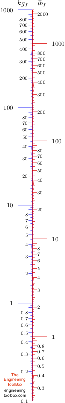

  • 1 kg gravitation force = 9.81 N = 2.20462 lbf
Weight Converter
Kg to lb Converter
Kg to lb converter
Download and print kg to lb Converter!
