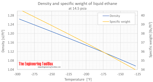

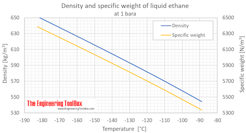

ρ = m / V (1)
γ = m g / V
= ρ g (2)
Tabulated values of ethane density and specific weight at given temperature and pressure (SI and Imperial units) as well as density units conversion are given below the figures.

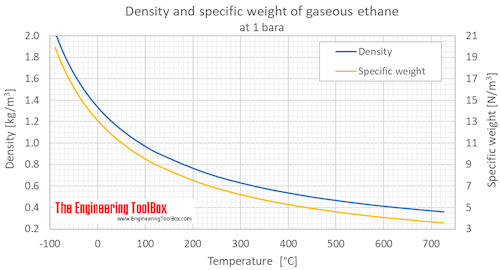

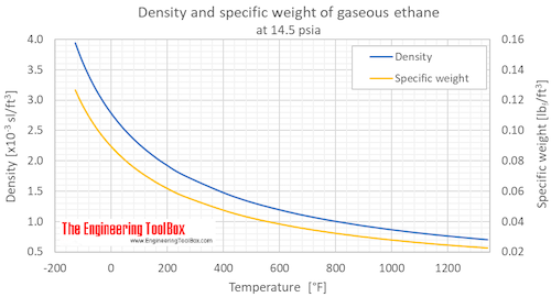

The calculator below can be used to estimate the density and specific weight of ethane at given temperature and atmospheric pressure. (Boiling point of ethane is -88°C / -127°F, and thus, ethane is present as liquid below this temperature)

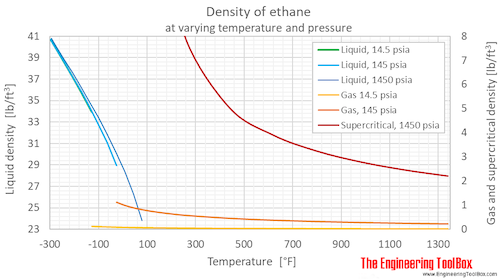

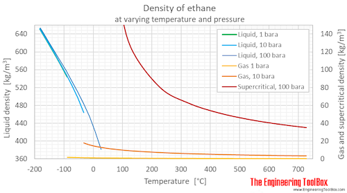

Density of ethane at varying temperature and pressure, SI and Imperial units:
The density of liquid ethane is nearly the same for all pressures up to 100 bara and -50 °C (-60°F), and the density of the liquid at equilibrium pressure can be used for most practical purposes.

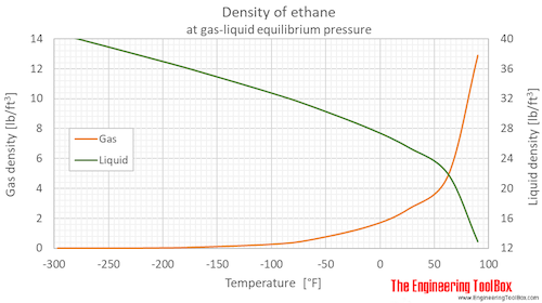

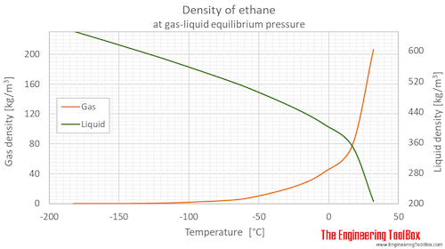

Density of ethane at varying temperature and equilibrium pressure, SI and Imperial units:
Density and specific weight of ethane at given temperatures and pressures:
