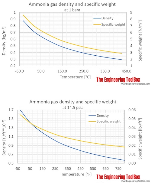

Ammonia density and specific weight at 1 bara:
Ammonia density specific weight C_F

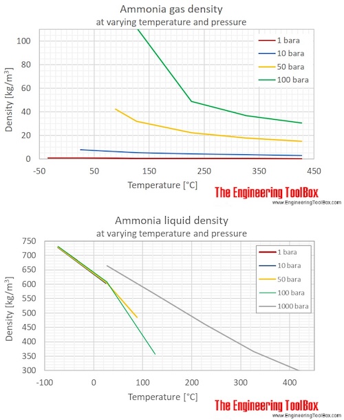

Ammonia gas and liquid density at varying  temperature and given pressures:
Ammonia density pressure gas liquid C
Ammonia gas density at given temperature (°C) and 1 bara pressure:
For full table with Specific Weight - rotate the screen!
Ammonia Gas - Density vs. Temperature and Pressure
Temperature Gas Density Specific weight
(°C) (g/l), (kg/m3) (mol/dm3) (lb/ft3) (N/m3)
-35 0.8843 0.0519 0.0552 8.672
-10 0.7938 0.0466 0.0496 7.785
0 0.7625 0.0448 0.0476 7.478
10 0.7336 0.0431 0.0458 7.194
20 0.7069 0.0415 0.0441 6.932
30 0.6822 0.0401 0.0426 6.690
40 0.6593 0.0387 0.0412 6.466
50 0.6380 0.0375 0.0398 6.257
75 0.5909 0.0347 0.0369 5.795
100 0.5509 0.0323 0.0344 5.402
125 0.5162 0.0303 0.0322 5.062
150 0.4858 0.0285 0.0303 4.764
175 0.4586 0.0269 0.0286 4.497
200 0.4341 0.0255 0.0271 4.257
250 0.3917 0.0230 0.0245 3.842
300 0.3573 0.0210 0.0223 3.503
350 0.3295 0.0194 0.0206 3.232
400 0.3058 0.0180 0.0191 2.999
Ammonia gas density at given temperature (°F) and 14.5 psia pressure:
(°F) (lb/ft3) (sl/ft3 ×10-3) (g/l)
(kg/m3)
(lbf/ft3)
-35 0.05577 1.733 0.8933 0.0558
0 0.05119 1.591 0.8200 0.0512
20 0.04889 1.519 0.7831 0.0489
40 0.04678 1.454 0.7494 0.0468
60 0.04486 1.394 0.7185 0.0449
80 0.04309 1.339 0.6902 0.0431
100 0.04147 1.289 0.6642 0.0415
120 0.03997 1.242 0.6403 0.0400
150 0.03794 1.179 0.6078 0.0379
200 0.03502 1.088 0.5610 0.0350
250 0.03254 1.012 0.5213 0.0325
300 0.03040 0.945 0.4870 0.0304
350 0.02852 0.886 0.4569 0.0285
400 0.02684 0.834 0.4299 0.0268
500 0.02399 0.746 0.3842 0.0240
600 0.02172 0.675 0.3480 0.0217
700 0.01993 0.620 0.3193 0.0199
800 0.01828 0.568 0.2928 0.0183
