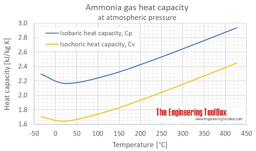

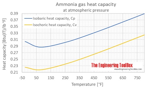

At ambient pressure and temperature the isobaric specific heat, CP, of ammonia is 2.2 (kJ/kg K) or 0.52 (Btu/lb °F) = (cal/g K), while the isochoric specific heat, CV, is 1.6 (kJ/kg K) or 0.39 (Btu/lb °F) = (cal/g K).
However, the specific heat - CP and CV - will vary with temperature. This may influence on the accuracy of ammonia conditioning and industrial ammonia handling process calculations. When calculating mass and volume flow of ammonia in heated or cooled systems with high accuracy - the specific heat should be corrected according values in the figures and table below, or found by use of the calculator.

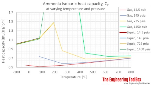

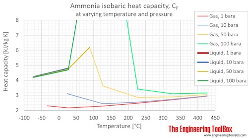

Isobaric specific heat, CP, of ammonia at given temperatures and pressure s:
For full table with specific heat at Constant Pressure - rotate the screen!
| State | Temperature | Pressure | Specific Heat at constant pressure, CP (isobaric) | Cp/Cv | ||||||||
| (K) | (°C) | (°F) | (MPa) | (bara) | (psia) | (kJ/mol K) | (kJ/kg K) | (kWh/(kg K)) | (kcal(IT)/(kg K)), (Btu(IT)/lb °F) | (Btu(IT)/(mol °F)) | (-) | |
| Liquid | -73.2 | -99.7 | 0.1 | 1 | 15 | 0.071983 | 4.2266 | 0.001174 | 1.009 | 0.03790 | 1.44 | |
| 239.56 | -33.6 | -28.5 | 0.1 | 1 | 15 | 0.075726 | 4.4464 | 0.001235 | 1.062 | 0.03987 | 1.56 | |
| Gas | 239.56 | -33.6 | -28.5 | 0.1 | 1 | 15 | 0.039079 | 2.2946 | 0.0006374 | 0.5480 | 0.02058 | 1.35 |
| 300 | 26.9 | 80.3 | 0.1 | 1 | 15 | 0.036849 | 2.1636 | 0.0006010 | 0.5168 | 0.01940 | 1.32 | |
| 400 | 127 | 260 | 0.1 | 1 | 15 | 0.038883 | 2.2831 | 0.0006342 | 0.5453 | 0.02047 | 1.28 | |
| 500 | 227 | 440 | 0.1 | 1 | 15 | 0.04228 | 2.4825 | 0.0006896 | 0.5929 | 0.02226 | 1.25 | |
| 600 | 327 | 620 | 0.1 | 1 | 15 | 0.046083 | 2.7058 | 0.0007516 | 0.6463 | 0.02426 | 1.22 | |
| 700 | 427 | 800 | 0.1 | 1 | 15 | 0.050015 | 2.9367 | 0.0008158 | 0.7014 | 0.02633 | 1.20 | |
| Liquid | 200 | -73.2 | -99.7 | 1 | 10 | 145 | 0.071938 | 4.2239 | 0.001173 | 1.009 | 0.03788 | 1.44 |
| 298.05 | 24.9 | 76.8 | 1 | 10 | 145 | 0.081465 | 4.7833 | 0.001329 | 1.142 | 0.04289 | 1.73 | |
| Gas | 298.05 | 24.9 | 76.8 | 1 | 10 | 145 | 0.053356 | 3.1329 | 0.0008703 | 0.7483 | 0.02809 | 1.47 |
| 300 | 26.9 | 80.3 | 1 | 10 | 145 | 0.052493 | 3.0822 | 0.0008562 | 0.7362 | 0.02764 | 1.46 | |
| 400 | 127 | 260 | 1 | 10 | 145 | 0.041627 | 2.4442 | 0.0006789 | 0.5838 | 0.02192 | 1.32 | |
| 500 | 227 | 440 | 1 | 10 | 145 | 0.04334 | 2.545 | 0.0007069 | 0.6078 | 0.02282 | 1.26 | |
| 600 | 327 | 620 | 1 | 10 | 145 | 0.04663 | 2.738 | 0.0007605 | 0.6539 | 0.02455 | 1.23 | |
| 700 | 427 | 800 | 1 | 10 | 145 | 0.05034 | 2.956 | 0.0008211 | 0.7060 | 0.02651 | 1.20 | |
| Liquid | 200 | -73.2 | -99.7 | 5 | 50 | 725 | 0.07174 | 4.212 | 0.001170 | 1.006 | 0.03777 | 1.43 |
| 300 | 26.9 | 80.3 | 5 | 50 | 725 | 0.08090 | 4.750 | 0.001319 | 1.135 | 0.04260 | 1.72 | |
| 362.03 | 88.9 | 192 | 5 | 50 | 725 | 0.10538 | 6.188 | 0.001719 | 1.478 | 0.05549 | 2.23 | |
| Gas | 362.03 | 88.9 | 192 | 5 | 50 | 725 | 0.10501 | 6.166 | 0.001713 | 1.473 | 0.05529 | 2.16 |
| 400 | 127 | 260 | 5 | 50 | 725 | 0.06158 | 3.616 | 0.001004 | 0.8636 | 0.03242 | 1.60 | |
| 500 | 227 | 440 | 5 | 50 | 725 | 0.04878 | 2.864 | 0.0007956 | 0.6841 | 0.02568 | 1.35 | |
| 600 | 327 | 620 | 5 | 50 | 725 | 0.04921 | 2.889 | 0.0008026 | 0.6901 | 0.02591 | 1.27 | |
| 700 | 427 | 800 | 5 | 50 | 725 | 0.05184 | 3.044 | 0.0008455 | 0.7270 | 0.02729 | 1.23 | |
| Liquid | 200 | -73.2 | -99.7 | 10 | 100 | 1450 | 0.07150 | 4.198 | 0.001166 | 1.003 | 0.03764 | 1.42 |
| 300 | 26.9 | 80.3 | 10 | 100 | 1450 | 0.07996 | 4.695 | 0.001304 | 1.121 | 0.04210 | 1.70 | |
| 398.32 | 125 | 257 | 10 | 100 | 1450 | 0.30653 | 18.00 | 0.005000 | 4.299 | 0.16140 | 5.77 | |
| Gas | 398.32 | 125 | 257 | 10 | 100 | 1450 | 0.46915 | 27.55 | 0.007652 | 6.579 | 0.24702 | 7.76 |
| 400 | 127 | 260 | 10 | 100 | 1450 | 0.30552 | 17.94 | 0.004983 | 4.285 | 0.16086 | 5.30 | |
| 500 | 227 | 440 | 10 | 100 | 1450 | 0.05806 | 3.409 | 0.0009470 | 0.8142 | 0.03057 | 1.50 | |
| 600 | 327 | 620 | 10 | 100 | 1450 | 0.05281 | 3.101 | 0.0008613 | 0.7406 | 0.02780 | 1.32 | |
| 700 | 427 | 800 | 10 | 100 | 1450 | 0.05380 | 3.159 | 0.0008774 | 0.7544 | 0.02833 | 1.25 | |
| Liquid | 300 | 26.9 | 80.3 | 100 | 1000 | 14500 | 0.07274 | 4.271 | 0.001186 | 1.020 | 0.03830 | 1.49 |
| 400 | 127 | 260 | 100 | 1000 | 14500 | 0.07557 | 4.437 | 0.001233 | 1.060 | 0.03979 | 1.62 | |
| 500 | 227 | 440 | 100 | 1000 | 14500 | 0.07550 | 4.433 | 0.001231 | 1.059 | 0.03975 | 1.64 | |
| 600 | 327 | 620 | 100 | 1000 | 14500 | 0.07519 | 4.415 | 0.001226 | 1.055 | 0.03959 | 1.61 | |
| 700 | 427 | 800 | 100 | 1000 | 14500 | 0.07519 | 4.415 | 0.001226 | 1.055 | 0.03959 | 1.56 | |

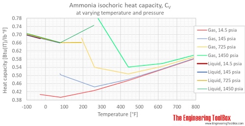

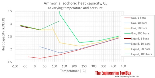

Isochoric specific heat, CV, of ammonia at given temperatures and pressure s:
For full table with specific heat at Constant Volume - rotate the screen!
| State | Temperature | Pressure | Specific Heat at constant volume, CV (isochoric) | Cp/Cv | ||||||||
| Liquid | -73.2 | -99.7 | 0.1 | 1 | 15 | 0.04984 | 2.927 | 0.0008129 | 0.6990 | 0.02624 | 1.44 | |
| 239.56 | -33.6 | -28.5 | 0.1 | 1 | 15 | 0.04863 | 2.855 | 0.0007931 | 0.6819 | 0.02560 | 1.56 | |
| Gas | 239.56 | -33.6 | -28.5 | 0.1 | 1 | 15 | 0.02901 | 1.703 | 0.0004731 | 0.4068 | 0.01527 | 1.35 |
| 300 | 26.9 | 80.3 | 0.1 | 1 | 15 | 0.02802 | 1.645 | 0.0004570 | 0.3930 | 0.01475 | 1.32 | |
| 400 | 127 | 260 | 0.1 | 1 | 15 | 0.03042 | 1.786 | 0.0004961 | 0.4266 | 0.01602 | 1.28 | |
| 500 | 227 | 440 | 0.1 | 1 | 15 | 0.03390 | 1.990 | 0.0005529 | 0.4754 | 0.01785 | 1.25 | |
| 600 | 327 | 620 | 0.1 | 1 | 15 | 0.03773 | 2.215 | 0.0006154 | 0.5291 | 0.01987 | 1.22 | |
| 700 | 427 | 800 | 0.1 | 1 | 15 | 0.04168 | 2.447 | 0.0006798 | 0.5845 | 0.02194 | 1.20 | |
| Liquid | 200 | -73.2 | -99.7 | 1 | 10 | 145 | 0.04989 | 2.929 | 0.0008137 | 0.6997 | 0.02627 | 1.44 |
| 298.05 | 24.9 | 76.8 | 1 | 10 | 145 | 0.04709 | 2.765 | 0.0007680 | 0.6603 | 0.02479 | 1.73 | |
| Gas | 298.05 | 24.9 | 76.8 | 1 | 10 | 145 | 0.03627 | 2.130 | 0.0005916 | 0.5087 | 0.01910 | 1.47 |
| 300 | 26.9 | 80.3 | 1 | 10 | 145 | 0.03587 | 2.106 | 0.0005850 | 0.5030 | 0.01888 | 1.46 | |
| 400 | 127 | 260 | 1 | 10 | 145 | 0.03164 | 1.858 | 0.0005161 | 0.4437 | 0.01666 | 1.32 | |
| 500 | 227 | 440 | 1 | 10 | 145 | 0.03431 | 2.015 | 0.0005596 | 0.4812 | 0.01807 | 1.26 | |
| 600 | 327 | 620 | 1 | 10 | 145 | 0.03793 | 2.227 | 0.0006186 | 0.5319 | 0.01997 | 1.23 | |
| 700 | 427 | 800 | 1 | 10 | 145 | 0.04179 | 2.454 | 0.0006816 | 0.5861 | 0.02200 | 1.20 | |
| Liquid | 200 | -73.2 | -99.7 | 5 | 50 | 725 | 0.05010 | 2.942 | 0.0008171 | 0.7026 | 0.02638 | 1.43 |
| 300 | 26.9 | 80.3 | 5 | 50 | 725 | 0.04709 | 2.765 | 0.0007681 | 0.6604 | 0.02479 | 1.72 | |
| 362.03 | 88.9 | 192 | 5 | 50 | 725 | 0.04715 | 2.769 | 0.0007691 | 0.6613 | 0.02483 | 2.23 | |
| Gas | 362.03 | 88.9 | 192 | 5 | 50 | 725 | 0.04872 | 2.861 | 0.0007947 | 0.6833 | 0.02565 | 2.16 |
| 400 | 127 | 260 | 5 | 50 | 725 | 0.03847 | 2.259 | 0.0006274 | 0.5395 | 0.02025 | 1.60 | |
| 500 | 227 | 440 | 5 | 50 | 725 | 0.03619 | 2.125 | 0.0005903 | 0.5076 | 0.01906 | 1.35 | |
| 600 | 327 | 620 | 5 | 50 | 725 | 0.03880 | 2.278 | 0.0006328 | 0.5441 | 0.02043 | 1.27 | |
| 700 | 427 | 800 | 5 | 50 | 725 | 0.04229 | 2.483 | 0.0006897 | 0.5931 | 0.02227 | 1.23 | |
| Liquid | 200 | -73.2 | -99.7 | 10 | 100 | 1450 | 0.05034 | 2.956 | 0.0008211 | 0.7060 | 0.02651 | 1.42 |
| 300 | 26.9 | 80.3 | 10 | 100 | 1450 | 0.04716 | 2.769 | 0.0007693 | 0.6614 | 0.02483 | 1.70 | |
| 398.32 | 125 | 257 | 10 | 100 | 1450 | 0.05315 | 3.121 | 0.0008669 | 0.7454 | 0.02798 | 5.77 | |
| Gas | 398.32 | 125 | 257 | 10 | 100 | 1450 | 0.06045 | 3.549 | 0.0009859 | 0.8477 | 0.03183 | 7.76 |
| 400 | 127 | 260 | 10 | 100 | 1450 | 0.05761 | 3.383 | 0.0009397 | 0.8079 | 0.03033 | 5.30 | |
| 500 | 227 | 440 | 10 | 100 | 1450 | 0.03860 | 2.267 | 0.0006296 | 0.5414 | 0.02033 | 1.50 | |
| 600 | 327 | 620 | 10 | 100 | 1450 | 0.03986 | 2.341 | 0.0006502 | 0.5590 | 0.02099 | 1.32 | |
| 700 | 427 | 800 | 10 | 100 | 1450 | 0.04290 | 2.519 | 0.0006996 | 0.6016 | 0.02259 | 1.25 | |
| Liquid | 300 | 26.9 | 80.3 | 100 | 1000 | 14500 | 0.04889 | 2.871 | 0.0007975 | 0.6857 | 0.02574 | 1.49 |
| 400 | 127 | 260 | 100 | 1000 | 14500 | 0.04664 | 2.738 | 0.0007606 | 0.6540 | 0.02456 | 1.62 | |
| 500 | 227 | 440 | 100 | 1000 | 14500 | 0.04600 | 2.701 | 0.0007503 | 0.6451 | 0.02422 | 1.64 | |
| 600 | 327 | 620 | 100 | 1000 | 14500 | 0.04672 | 2.743 | 0.0007621 | 0.6552 | 0.02460 | 1.61 | |
| 700 | 427 | 800 | 100 | 1000 | 14500 | 0.04833 | 2.838 | 0.0007883 | 0.6778 | 0.02545 | 1.56 | |
