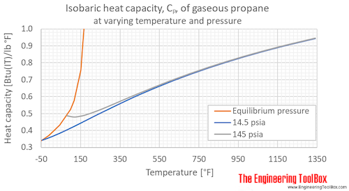

Isobaric specific heat, CP, of gaseous propane with varing temperature, given as °C and °F:

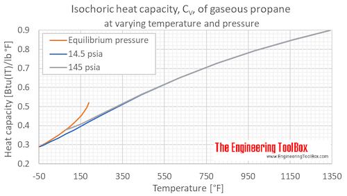

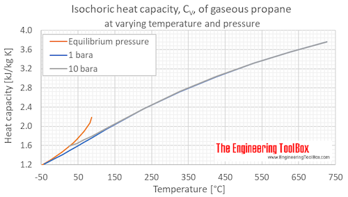

Isochoric specfic heat, CV, of gaseous propane with varing temperature, given as °C and °F:

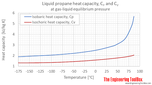

Isobaric and isochoric specific heat (specific heat), CP and CV, of liquid propane with varing temperature, given as °C and °F:
