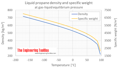

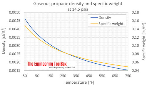

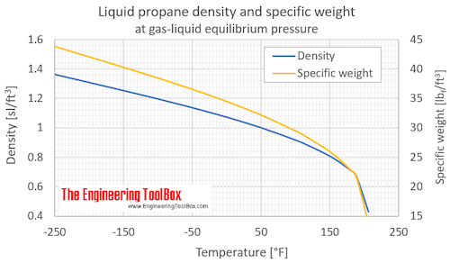

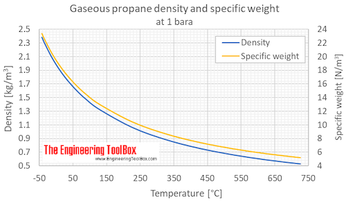

Density of gaseous propane at varying temperature and pressure, SI and Imperial units:

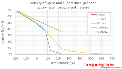

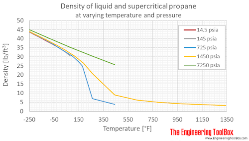

Density of liquid and supercritical propane at varying temperature and pressure, SI and Imperial units:
The density of liquid propane is nearly the same for all pressures up to 100 bara and 50 °C (100°F), and the density of the liquid at equilibrium pressure can be used for most practical purposes.
