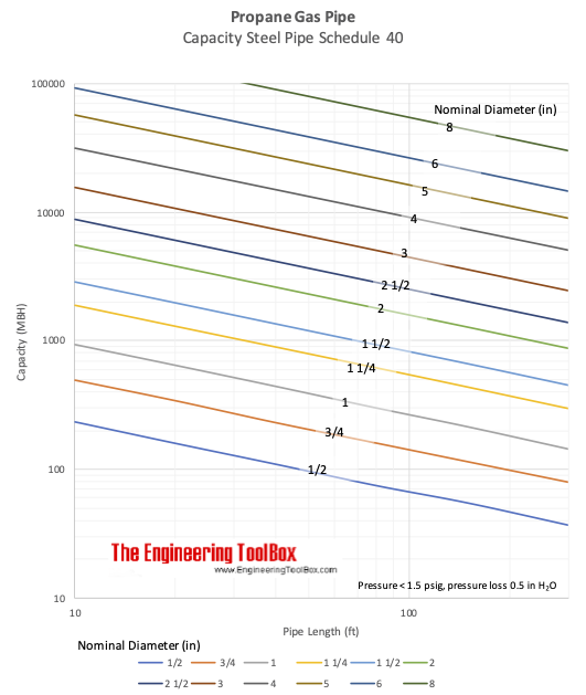

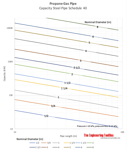

Sizing of low pressure propane gas pipe lines - Imperial units.
The tables and diagrams below can be used for sizing propane gas pipes.
Steel Pipe - Schedule 40
Propane gas piping - sizing diagram
Propane Gas - Low Pressure Capacities in Steel Pipes Schedule 40
Pipe Size
(in)
Capacity of Pipe (MBH)
Pipe Length (ft)
10204080150300
1/2 235 160 110 75 55 35
3/4 490 340 230 160 115 80
1 925 640 440 300 215 145
1 1/4 1900 1305 900 620 440 300
1 1/2 2850 1960 1345 925 660 450
2 5490 3770 2590 1780 1270 870
2 1/2 8740 6010 4130 2840 2020 1390
3 15455 10620 7300 5020 3570 2450
4 31525 21670 14890 10230 7280 5010
5 57030 39200 26940 18520 13180 9060
6 92350 63470 43620 29980 21340 14665
8 189750 130410 89630 61600 43840 30135
  • pressure less than 1 1/2 psig
  • fittings factor 1.5 - equivalent pipe length = pipe length + 50%
  • pressure drop 0.5 inches water column
  • energy content in propane gas 2520 Btu/cu ft
  • One MBH is equivalent to 1000 BTU's per hour
  • 1 CFH ≈ 2.54 MBH
  • steel pipes schedule 40

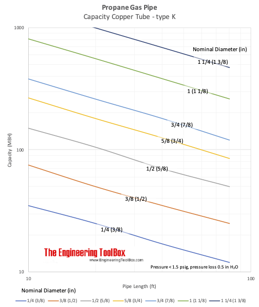

Copper Tubing - type K
Propane gas pipe sizing of copper pipe type k - diagram
Propane Gas - Low Pressure Capacities in Copper Tubes - type K
Nominal Pipe Size (O.D)
(in)
Pipe Length (ft)
10204080
1/4 (3/8) 35 25 17 12
3/8 (1/2) 75 50 35 25
1/2 (5/8) 150 105 70 50
5/8 (3/4) 265 180 125 85
3/4 (7/8) 380 260 180 120
1 (1 1/8) 805 555 380 260
1 1/4 (1 3/8) 1450 995 685 470
  • energy content in propane gas 2500 Btu/cu ft
  • 1 CFH ≈ 2.54 MBH
  • copper tubing type K
