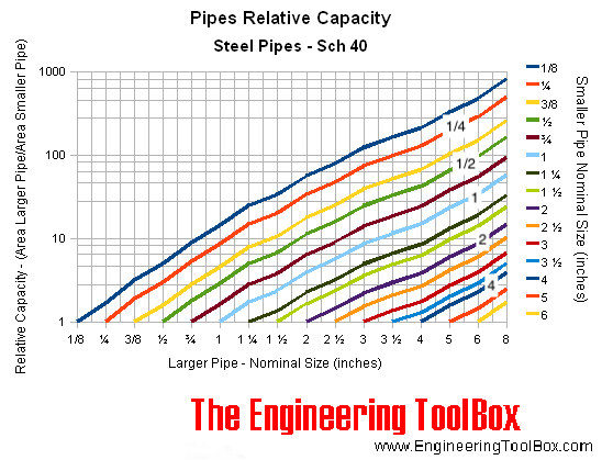

Pipes - Relative Capacity
Relative capacity between larger and smaller pipes.
Pipes relative capacity - the capacity of the larger pipe versus the smaller pipe:
The diagram above and table below are for steel pipes schedule 40.
For full table with larger sizes - rotate the screen!
