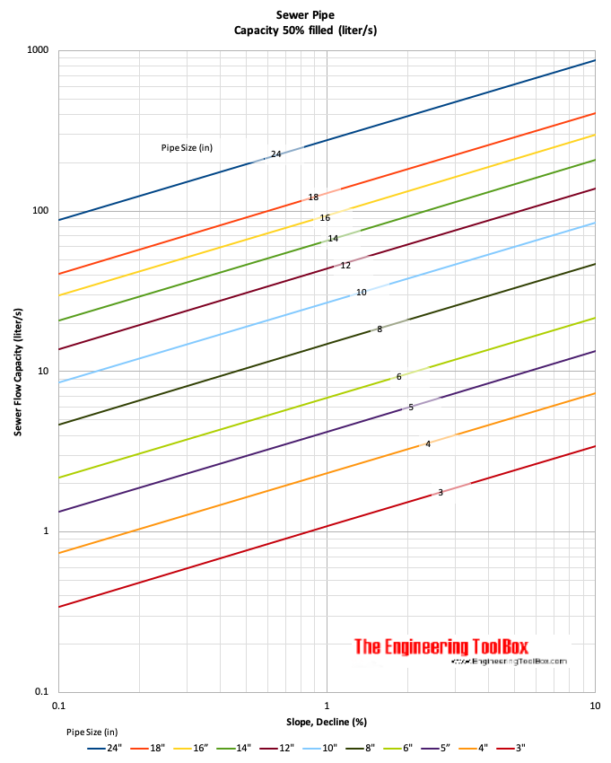

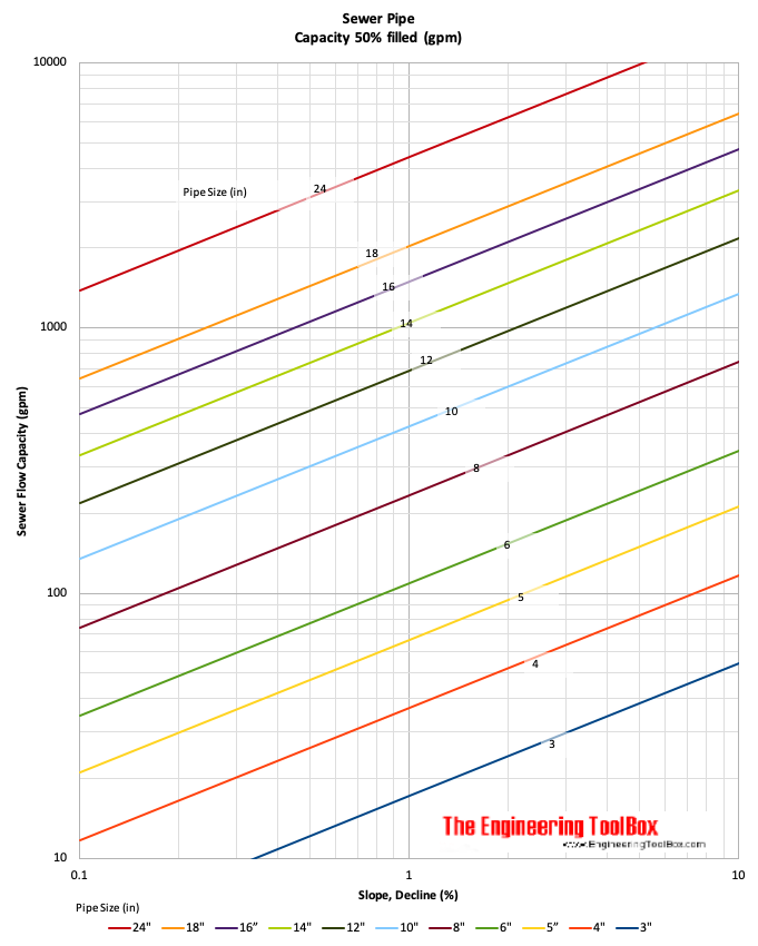

The diagrams below can be used for design of sewage and wastewater gravity conveying systems.
Sewage Pipe Capacity - Imperial units - gpm
Sewage wastewater pipe - capacity in gpm
Sewage Pipe Capacity - SI Units - liter per second
Sewage wastewater pipe - capacity in liter per second
Note! - the charts are based on clean plastic pipes - calculated with the Manning formularoughness coefficient 0.015 and fill 50%.
@Example - Capacity of a Sewer Pipe
The capacity of a 4 inch sewer pipe with decline 0.5% is aprox. 25 gpm (1.6 liter/s).
