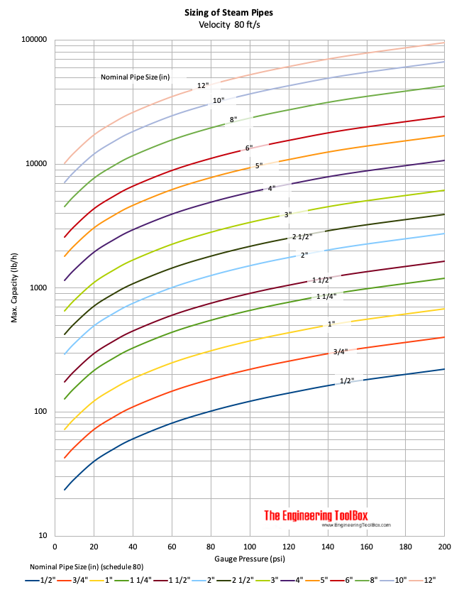

Sizing Steam Pipes (lb/h)
Steam is a compressible gas where the capacity of a pipe line depends on the size of the pipe and the steam pressure.
This table below can be used for fast calculation of steam pipes sch. 80.
- in general - 80 ft/sec is a recommended steam velocity
For full table with larger dimensions - rotate the screen!

Example - Sizing Steam Pipe Lines
A 4 inch sch. 80 steel pipe with 100 psi steam pressure has a capacity of 5923 lb/h with steam velocity 80 ft/s.
