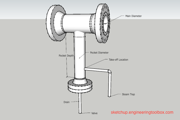

Steam pipe line - drip leg for condensate
The 3D model above is made with sketchup.engineeringtoolbox.com
Condensate is generated in the steam pipes due to heat loss and due to energy required during system heat up. For the steam system to work properly it is important that the condensate is removed.

Recommended Drip Leg Dimensions
Steam Pipes - Drip Leg Dimensions
Main DiameterPocket DiameterPocket Depth
(mm)(in)(mm)(in)(mm)(in)
50 2 50 2 700 28
80 3 80 3 700 28
100 4 100 4 700 28
250 10 150 6 700 28
500 20 250 10 700 28
Example - Drip Leg Dimensions
The recommended drip leg dimension for a 80 mm (3 in) steam pipe is 80 mm (3 in). The pocket depth should be 700 mm (28 in).
