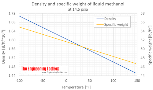

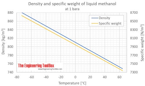

Density and specific weight of gaseous methanol at varying temperature and atmospheric pressure, SI and Imperial units:
Methanol density 1 bara C
Methanol density 1 bara F

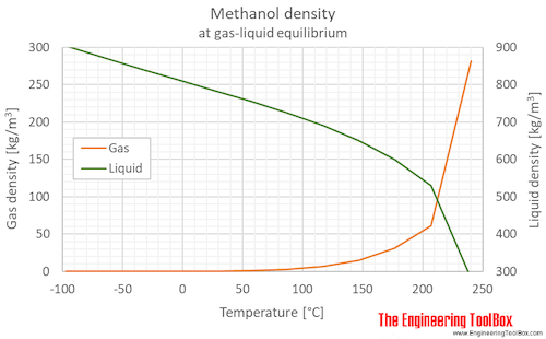

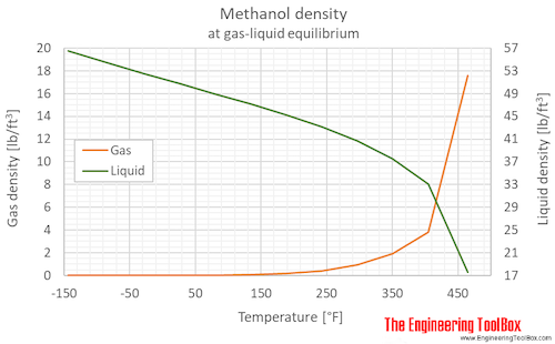

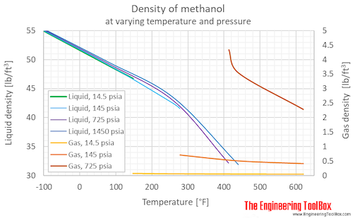

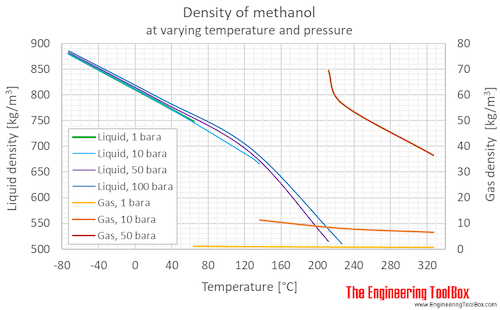

Density of methanol at varying temperature and pressure, SI and Imperial units:
Methanol density pressure C
Methanol density pressure F
The density of liquid methanol is nearly the same for all pressures up to 100 bara and 25 °C (77°F), and the density of the liquid at equilibrium pressure can be used for most practical purposes.
Density of methanol at varying temperature and equilibrium pressure, SI and Imperial units: Methanol density equilibrium C
Methanol density equilibrium F
