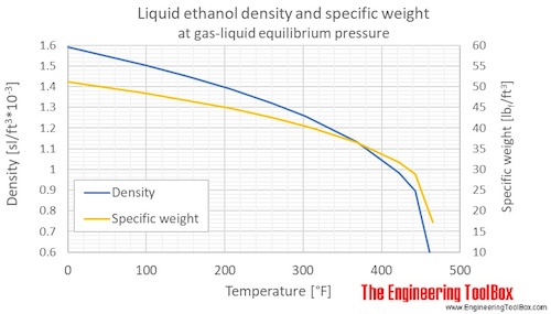

Tabulated values of ethanol density and specific weight at given temperature and pressure (SI and Imperial units) as well as density units conversion are given below the figures.

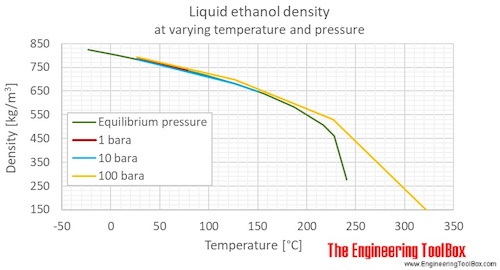

Density of liquid ethanol at varying temperature (°C) and given pressures:
The density of liquid ethanol is nearly the same for all pressures up to 100 bara, and the density of the liquid at equilibrium pressure (as used in the calculator above) can be used for most practical purposes.

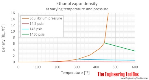

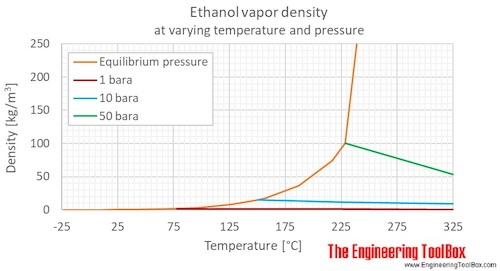

Density of ethanol vapor (singel phase) at varying temperature and given pressures, SI and Imperial units:
