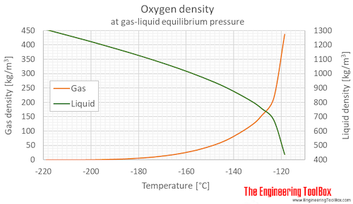

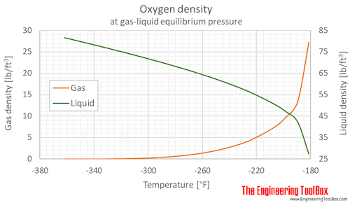

Density of oxygen at varying temperature and pressure, SI and Imperial units:
Density of oxygen at varying temperature and equilibrium pressure, SI and Imperial units:

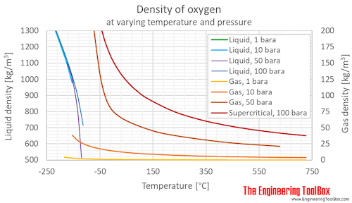

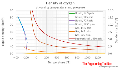

Density and specific weight of oxygen at given temperatures and pressures:
| State | Temperature | Pressure | Density | Specific weight | |||||||
| (K) | (°C) | (°F) | (bara) | (psia) | (mol/dm3) | (g/l), (kg/m3) | (lbm/ft3) | (sl/ft3) | (N/m3) | (lbf/ft3) | |
| Liquid at equilibrium | 54.361 | -218.79 | -361.82 | 0.0015 | 0.0212 | 40.82 | 1306 | 81.54 | 2.534 | 12809 | 81.54 |
| 70 | -203 | -334 | 0.0626 | 0.908 | 38.66 | 1237 | 77.22 | 2.400 | 12131 | 77.22 | |
| 75 | -198 | -325 | 0.145 | 2.11 | 37.94 | 1214 | 75.78 | 2.355 | 11905 | 75.78 | |
| 80 | -193 | -316 | 0.301 | 4.37 | 37.20 | 1190 | 74.32 | 2.310 | 11675 | 74.32 | |
| 90 | -183 | -298 | 0.994 | 14.4 | 35.69 | 1142 | 71.30 | 2.216 | 11201 | 71.30 | |
| 100 | -173 | -280 | 2.54 | 36.8 | 34.09 | 1091 | 68.11 | 2.117 | 10699 | 68.11 | |
| 110 | -163 | -262 | 5.43 | 78.8 | 32.36 | 1036 | 64.65 | 2.009 | 10155 | 64.65 | |
| 120 | -153 | -244 | 10.2 | 148.3 | 30.43 | 973.9 | 60.80 | 1.890 | 9551 | 60.80 | |
| 130 | -143 | -226 | 17.5 | 253.7 | 28.20 | 902.5 | 56.34 | 1.751 | 8850 | 56.34 | |
| 140 | -133 | -208 | 27.9 | 404.3 | 25.42 | 813.3 | 50.77 | 1.578 | 7976 | 50.77 | |
| 145 | -128 | -199 | 34.5 | 500.0 | 23.60 | 755.2 | 47.14 | 1.465 | 7406 | 47.14 | |
| 150 | -123 | -190 | 42.2 | 611.9 | 21.11 | 675.5 | 42.17 | 1.311 | 6625 | 42.17 | |
| 154.58 | -118.57 | -181.43 | 50.4 | 731.4 | 13.63 | 436.2 | 27.23 | 0.846 | 4277 | 27.23 | |
| Gas at equilibrium | 54.361 | -218.79 | -361.82 | 0.0015 | 0.0212 | 0.000324 | 0.01036 | 0.000647 | 0.000020 | 0.1016 | 0.000647 |
| 70 | -203 | -334 | 0.0626 | 0.908 | 0.01080 | 0.3457 | 0.02158 | 0.00067 | 3.390 | 0.02158 | |
| 75 | -198 | -325 | 0.145 | 2.11 | 0.02351 | 0.7523 | 0.04696 | 0.00146 | 7.377 | 0.04696 | |
| 80 | -193 | -316 | 0.301 | 4.37 | 0.04589 | 1.469 | 0.09168 | 0.00285 | 14.40 | 0.09168 | |
| 90 | -183 | -298 | 0.994 | 14.4 | 0.1371 | 4.387 | 0.2739 | 0.00851 | 43.02 | 0.2739 | |
| 100 | -173 | -280 | 2.54 | 36.8 | 0.3258 | 10.43 | 0.6508 | 0.02023 | 102.2 | 0.6508 | |
| 110 | -163 | -262 | 5.43 | 78.8 | 0.6651 | 21.28 | 1.329 | 0.04129 | 208.7 | 1.329 | |
| 120 | -153 | -244 | 10.2 | 148.3 | 1.228 | 39.31 | 2.454 | 0.07627 | 385.5 | 2.454 | |
| 130 | -143 | -226 | 17.5 | 253.7 | 2.137 | 68.37 | 4.268 | 0.1327 | 670.5 | 4.268 | |
| 140 | -133 | -208 | 27.9 | 404.3 | 3.649 | 116.8 | 7.289 | 0.2265 | 1145 | 7.289 | |
| 145 | -128 | -199 | 34.5 | 500.0 | 4.841 | 154.9 | 9.671 | 0.3006 | 1519 | 9.671 | |
| 150 | -123 | -190 | 42.2 | 611.9 | 6.717 | 214.9 | 13.42 | 0.4171 | 2108 | 13.42 | |
| 154.58 | -118.57 | -181.43 | 50.4 | 731.4 | 13.63 | 436.2 | 27.23 | 0.8463 | 4277 | 27.23 | |
| Liquid | 54.37 | -218.8 | -361.8 | 1 | 14.5 | 40.81 | 1306 | 81.53 | 2.534 | 12807 | 81.53 |
| 60 | -213 | -352 | 1 | 14.5 | 40.06 | 1282 | 80.03 | 2.487 | 12572 | 80.03 | |
| 80 | -193 | -316 | 1 | 14.5 | 37.22 | 1191 | 74.35 | 2.311 | 11680 | 74.35 | |
| 90.06 | -183.09 | -297.56 | 1 | 14.5 | 35.69 | 1142 | 71.29 | 2.216 | 11199 | 71.29 | |

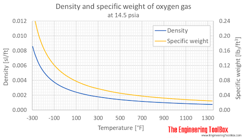

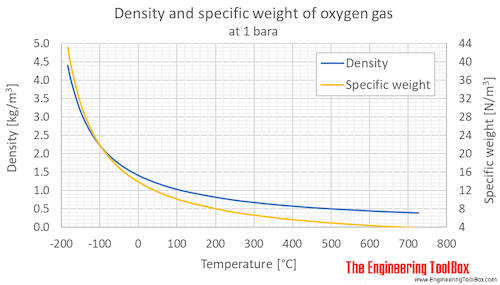

| Gas | 90.06 | -183.09 | -297.56 | 1 | 14.5 | 0.1379 | 4.413 | 0.2755 | 0.00856 | 43.28 | 0.2755 |
| 100 | -173 | -280 | 1 | 14.5 | 0.1232 | 3.941 | 0.2460 | 0.00765 | 38.65 | 0.2460 | |
| 120 | -153 | -244 | 1 | 14.5 | 0.1016 | 3.252 | 0.2030 | 0.00631 | 31.89 | 0.2030 | |
| 140 | -133 | -208 | 1 | 14.5 | 0.08669 | 2.774 | 0.1732 | 0.00538 | 27.20 | 0.1732 | |
| 160 | -113 | -172 | 1 | 14.5 | 0.07563 | 2.420 | 0.1511 | 0.00470 | 23.73 | 0.1511 | |
| 180 | -93.2 | -136 | 1 | 14.5 | 0.06710 | 2.147 | 0.1340 | 0.00417 | 21.05 | 0.1340 | |
| 200 | -73.2 | -99.7 | 1 | 14.5 | 0.06031 | 1.930 | 0.1205 | 0.00374 | 18.93 | 0.1205 | |
| 220 | -53.2 | -63.7 | 1 | 14.5 | 0.05478 | 1.753 | 0.1094 | 0.00340 | 17.19 | 0.1094 | |
| 240 | -33.2 | -27.7 | 1 | 14.5 | 0.05019 | 1.606 | 0.1003 | 0.00312 | 15.75 | 0.1003 | |
| 260 | -13.2 | 8.3 | 1 | 14.5 | 0.04631 | 1.482 | 0.09252 | 0.00288 | 14.53 | 0.09252 | |
| 280 | 6.9 | 44.3 | 1 | 14.5 | 0.04300 | 1.376 | 0.08590 | 0.00267 | 13.49 | 0.08590 | |
| 300 | 26.9 | 80.3 | 1 | 14.5 | 0.04013 | 1.284 | 0.08016 | 0.00249 | 12.59 | 0.08016 | |
| 320 | 46.9 | 116 | 1 | 14.5 | 0.03760 | 1.203 | 0.07510 | 0.00233 | 11.80 | 0.07510 | |
| 340 | 66.9 | 152 | 1 | 14.5 | 0.03538 | 1.132 | 0.07067 | 0.00220 | 11.10 | 0.07067 | |
| 360 | 86.9 | 188 | 1 | 14.5 | 0.03341 | 1.069 | 0.06674 | 0.00207 | 10.48 | 0.06674 | |
| 400 | 127 | 260 | 1 | 14.5 | 0.03007 | 0.9622 | 0.06007 | 0.00187 | 9.436 | 0.06007 | |
| 500 | 227 | 440 | 1 | 14.5 | 0.02405 | 0.7696 | 0.04804 | 0.00149 | 7.547 | 0.04804 | |
| 600 | 327 | 620 | 1 | 14.5 | 0.02004 | 0.6413 | 0.04004 | 0.00124 | 6.289 | 0.04004 | |
| 700 | 427 | 800 | 1 | 14.5 | 0.01718 | 0.5497 | 0.03432 | 0.00107 | 5.391 | 0.03432 | |
| 800 | 527 | 980 | 1 | 14.5 | 0.01503 | 0.4809 | 0.03002 | 0.000933 | 4.716 | 0.03002 | |
| 900 | 627 | 1160 | 1 | 14.5 | 0.01336 | 0.4275 | 0.02669 | 0.000829 | 4.192 | 0.02669 | |
| 1000 | 727 | 1340 | 1 | 14.5 | 0.01203 | 0.3848 | 0.02402 | 0.000747 | 3.774 | 0.02402 | |
| Liquid | 54.47 | -218.68 | -361.62 | 10 | 145 | 40.85 | 1307 | 81.59 | 2.536 | 12817 | 81.59 |
| 60 | -213 | -352 | 10 | 145 | 40.10 | 1283 | 80.10 | 2.489 | 12582 | 80.10 | |
| 80 | -193 | -316 | 10 | 145 | 37.25 | 1192 | 74.41 | 2.313 | 11690 | 74.41 | |
| 100 | -173 | -280 | 10 | 145 | 34.16 | 1093 | 68.23 | 2.121 | 10719 | 68.23 | |
| 119.62 | -153.53 | -244.35 | 10 | 145 | 30.51 | 976.3 | 60.95 | 1.894 | 9574 | 60.95 | |
| Gas | 119.62 | -153.53 | -244.35 | 10 | 145 | 1.202 | 38.46 | 2.401 | 0.07462 | 377.2 | 2.401 |
| 120 | -153 | -244 | 10 | 145 | 1.195 | 38.25 | 2.388 | 0.07422 | 375.1 | 2.388 | |
| 140 | -133 | -208 | 10 | 145 | 0.9497 | 30.39 | 1.897 | 0.05897 | 298.0 | 1.897 | |
| 160 | -113 | -172 | 10 | 145 | 0.8016 | 25.65 | 1.601 | 0.04977 | 251.5 | 1.601 | |
| 180 | -93.2 | -136 | 10 | 145 | 0.6978 | 22.33 | 1.394 | 0.04333 | 219.0 | 1.394 | |
| 200 | -73.2 | -99.7 | 10 | 145 | 0.6200 | 19.84 | 1.239 | 0.03850 | 194.6 | 1.239 | |
| 220 | -53.2 | -63.7 | 10 | 145 | 0.5588 | 17.88 | 1.116 | 0.03469 | 175.3 | 1.116 | |
| 240 | -33.2 | -27.7 | 10 | 145 | 0.5094 | 16.30 | 1.018 | 0.03163 | 159.8 | 1.018 | |
| 260 | -13.2 | 8.3 | 10 | 145 | 0.4681 | 14.98 | 0.9352 | 0.02907 | 146.9 | 0.9352 | |
| 280 | 6.9 | 44.3 | 10 | 145 | 0.4331 | 13.86 | 0.8653 | 0.02689 | 135.9 | 0.8653 | |
| 300 | 26.9 | 80.3 | 10 | 145 | 0.4035 | 12.91 | 0.8059 | 0.02505 | 126.6 | 0.8059 | |
| 320 | 46.9 | 116 | 10 | 145 | 0.3775 | 12.08 | 0.7541 | 0.02344 | 118.5 | 0.7541 | |
| 340 | 66.9 | 152 | 10 | 145 | 0.3547 | 11.35 | 0.7086 | 0.02202 | 111.3 | 0.7086 | |
| 360 | 86.9 | 188 | 10 | 145 | 0.3347 | 10.71 | 0.6686 | 0.02078 | 105.0 | 0.6686 | |
| 400 | 127 | 260 | 10 | 145 | 0.3007 | 9.623 | 0.6007 | 0.01867 | 94.37 | 0.6007 | |
| 500 | 227 | 440 | 10 | 145 | 0.2401 | 7.683 | 0.4796 | 0.01491 | 75.34 | 0.4796 | |
| 600 | 327 | 620 | 10 | 145 | 0.1999 | 6.398 | 0.3994 | 0.01241 | 62.74 | 0.3994 | |
| 700 | 427 | 800 | 10 | 145 | 0.1714 | 5.483 | 0.3423 | 0.01064 | 53.77 | 0.3423 | |
| 800 | 527 | 980 | 10 | 145 | 0.1499 | 4.798 | 0.2995 | 0.00931 | 47.05 | 0.2995 | |
| 900 | 627 | 1160 | 10 | 145 | 0.1333 | 4.265 | 0.2663 | 0.00828 | 41.83 | 0.2663 | |
| 1000 | 727 | 1340 | 10 | 145 | 0.1200 | 3.839 | 0.2397 | 0.00745 | 37.65 | 0.2397 | |
| Liquid | 100 | -173 | -280 | 50 | 725 | 34.50 | 1104 | 68.91 | 2.142 | 10826 | 68.91 |
| 154.36 | -118.79 | -181.82 | 50 | 725 | 16.01 | 512.4 | 31.99 | 0.994 | 5024 | 31.99 | |
| Gas | 154.36 | -118.79 | -181.82 | 50 | 725 | 11.16 | 357.1 | 22.29 | 0.693 | 3502 | 22.29 |
| 300 | 26.9 | 80.3 | 50 | 725 | 2.062 | 65.97 | 4.12 | 0.128 | 647.0 | 4.118 | |
| 500 | 227 | 440 | 50 | 725 | 1.191 | 38.11 | 2.379 | 0.07394 | 373.7 | 2.379 | |
| 700 | 427 | 800 | 50 | 725 | 0.8473 | 27.11 | 1.693 | 0.05261 | 265.9 | 1.693 | |
| 900 | 627 | 1160 | 50 | 725 | 0.6593 | 21.10 | 1.317 | 0.04094 | 206.9 | 1.317 | |
| Liquid | 55.5 | -217.65 | -359.77 | 100 | 1450 | 41.00 | 1312 | 81.91 | 2.546 | 12866 | 81.91 |
| 60 | -213 | -352 | 100 | 1450 | 40.44 | 1294 | 80.78 | 2.511 | 12690 | 80.78 | |
| 80 | -193 | -316 | 100 | 1450 | 37.72 | 1207 | 75.35 | 2.342 | 11837 | 75.35 | |
| 100 | -173 | -280 | 100 | 1450 | 34.88 | 1116 | 69.67 | 2.165 | 10944 | 69.67 | |
| 120 | -153 | -244 | 100 | 1450 | 31.72 | 1015 | 63.36 | 1.969 | 9954 | 63.36 | |
| 140 | -133 | -208 | 100 | 1450 | 27.89 | 892.5 | 55.72 | 1.732 | 8752 | 55.72 | |
| 160 | -113 | -172 | 100 | 1450 | 22.38 | 716.0 | 44.70 | 1.389 | 7022 | 44.70 | |
| Supercritical phase | 180 | -93.2 | -136 | 100 | 1450 | 13.23 | 423.3 | 26.43 | 0.8213 | 4151 | 26.43 |
| 200 | -73.2 | -99.7 | 100 | 1450 | 8.675 | 277.6 | 17.33 | 0.5386 | 2722 | 17.33 | |
| 220 | -53.2 | -63.7 | 100 | 1450 | 6.872 | 219.9 | 13.73 | 0.4267 | 2156 | 13.73 | |
| 240 | -33.2 | -27.7 | 100 | 1450 | 5.835 | 186.7 | 11.66 | 0.3623 | 1831 | 11.66 | |
| 260 | -13.2 | 8.3 | 100 | 1450 | 5.131 | 164.2 | 10.25 | 0.3186 | 1610 | 10.25 | |
| 280 | 6.9 | 44.3 | 100 | 1450 | 4.613 | 147.6 | 9.214 | 0.2864 | 1447 | 9.214 | |
| 300 | 26.9 | 80.3 | 100 | 1450 | 4.206 | 134.6 | 8.403 | 0.2612 | 1320 | 8.403 | |
| 320 | 46.9 | 116 | 100 | 1450 | 3.875 | 124.0 | 7.741 | 0.2406 | 1216 | 7.741 | |
| 340 | 66.9 | 152 | 100 | 1450 | 3.600 | 115.2 | 7.192 | 0.2235 | 1130 | 7.192 | |
| 360 | 86.9 | 188 | 100 | 1450 | 3.369 | 107.8 | 6.730 | 0.2092 | 1057 | 6.730 | |
| 400 | 127 | 260 | 100 | 1450 | 2.990 | 95.67 | 5.972 | 0.1856 | 938.2 | 5.972 | |
| 500 | 227 | 440 | 100 | 1450 | 2.354 | 75.32 | 4.702 | 0.1461 | 738.6 | 4.702 | |
| 600 | 327 | 620 | 100 | 1450 | 1.951 | 62.44 | 3.898 | 0.1212 | 612.3 | 3.898 | |
| 700 | 427 | 800 | 100 | 1450 | 1.671 | 53.46 | 3.337 | 0.1037 | 524.3 | 3.337 | |
| 800 | 527 | 980 | 100 | 1450 | 1.462 | 46.79 | 2.921 | 0.09079 | 458.9 | 2.921 | |
| 900 | 627 | 1160 | 100 | 1450 | 1.301 | 41.63 | 2.599 | 0.08078 | 408.3 | 2.599 | |
| 1000 | 727 | 1340 | 100 | 1450 | 1.172 | 37.51 | 2.342 | 0.07278 | 367.8 | 2.342 | |
| Liquid | 100 | -173 | -280 | 250 | 3626 | 35.88 | 1148 | 71.69 | 2.228 | 11261 | 71.69 |
Supercritical |
300 | 26.9 | 80.3 | 250 | 3626 | 10.39 | 332.6 | 20.76 | 0.6453 | 3261 | 20.76 |
| 500 | 227 | 440 | 250 | 3626 | 5.624 | 180.0 | 11.24 | 0.3492 | 1765 | 11.24 | |
| 700 | 427 | 800 | 250 | 3626 | 3.992 | 127.8 | 7.975 | 0.2479 | 1253 | 7.975 | |
