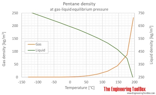

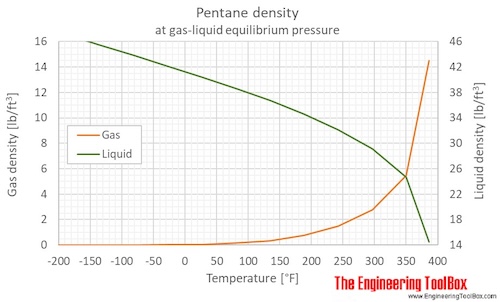

Density of pentane along the boiling and condensation curve, SI and Imperial units:
The density of liquid pentane is nearly the same for all pressures up to 100 bara, and the density of the liquid at equilibrium pressure can be used for most practical purposes.

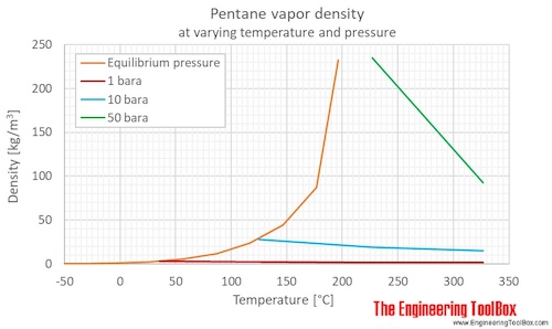

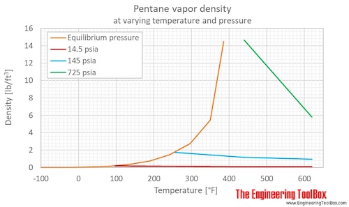

Density of pentane vapor (singel phase) at varying temperature and given pressures, SI and Imperial units:
Density and specific weight of pentane at given temperatures and pressures:

Liquid at equilibrium pressure |
143.47 | -129.7 | -201.4 | 7.63E-08 | 7.63E-07 | 1.10E-05 | 10.57 | 762.3 | 47.59 | 1.479 | 7476 | 47.6 |
| 150 | -123 | -190 | 2.68E-07 | 2.68E-06 | 3.89E-05 | 10.48 | 756.3 | 47.21 | 1.467 | 7416 | 47.2 | |
| 180 | -93.2 | -136 | 0.000023 | 0.00023 | 0.0034 | 10.11 | 729.1 | 45.51 | 1.415 | 7150 | 45.5 | |
| 210 | -63.2 | -81.7 | 0.00048 | 0.00482 | 0.0699 | 9.734 | 702.3 | 43.84 | 1.363 | 6887 | 43.8 | |
| 240 | -33.2 | -27.7 | 0.00421 | 0.0421 | 0.611 | 9.361 | 675.4 | 42.16 | 1.311 | 6623 | 42.2 | |
| 270 | -3.1 | 26.3 | 0.0211 | 0.211 | 3.07 | 8.979 | 647.8 | 40.44 | 1.257 | 6353 | 40.4 | |
| 300 | 26.9 | 80.3 | 0.0732 | 0.732 | 10.6 | 8.579 | 619.0 | 38.64 | 1.201 | 6070 | 38.6 | |
| 330 | 56.9 | 134 | 0.196 | 1.96 | 28.4 | 8.150 | 588.0 | 36.71 | 1.141 | 5766 | 36.7 | |
| 360 | 86.9 | 188 | 0.436 | 4.36 | 63.2 | 7.677 | 553.9 | 34.58 | 1.075 | 5431 | 34.6 | |
| 390 | 117 | 242 | 0.851 | 8.51 | 123 | 7.132 | 514.6 | 32.12 | 0.998 | 5046 | 32.1 | |
| 420 | 147 | 296 | 1.51 | 15.1 | 218 | 6.460 | 466.0 | 29.09 | 0.904 | 4570 | 29.1 | |
| 450 | 177 | 350 | 2.48 | 24.8 | 360 | 5.487 | 395.9 | 24.71 | 0.768 | 3882 | 24.7 | |
| 469.70 | 196.6 | 385.8 | 3.37 | 33.7 | 489 | 3.216 | 232.0 | 14.48 | 0.450 | 2275 | 14.5 | |
Gas at equilibrium pressure |
143.47 | -129.7 | -201.4 | 7.63E-08 | 7.63E-07 | 1.11E-05 | 6.40E-08 | 4.62E-06 | 2.88E-07 | 8.96E-09 | 4.53E-05 | 2.88E-07 |
| 150 | -123 | -190 | 2.68E-07 | 2.68E-06 | 3.89E-05 | 2.15E-07 | 1.55E-05 | 9.68E-07 | 3.01E-08 | 1.52E-04 | 9.68E-07 | |
| 180 | -93.2 | -136 | 2.33E-05 | 2.33E-04 | 0.0034 | 1.55E-05 | 0.00112 | 7.00E-05 | 2.18E-06 | 0.011 | 7.0E-05 | |
| 210 | -63.2 | -81.7 | 4.82E-04 | 0.00482 | 0.0699 | 2.76E-04 | 0.0199 | 0.00124 | 3.87E-05 | 0.195 | 0.00124 | |
| 240 | -33.2 | -27.7 | 0.00421 | 0.0421 | 0.611 | 0.002120 | 0.1529 | 0.00955 | 2.97E-04 | 1.50 | 0.00955 | |
| 270 | -3.1 | 26.3 | 0.0211 | 0.211 | 3.07 | 0.009555 | 0.6894 | 0.04304 | 0.00134 | 6.76 | 0.0430 | |
| 300 | 26.9 | 80.3 | 0.0732 | 0.732 | 10.6 | 0.03041 | 2.194 | 0.1369 | 0.00426 | 21.5 | 0.137 | |
| 330 | 56.9 | 134 | 0.196 | 1.96 | 28.4 | 0.07673 | 5.536 | 0.3456 | 0.01074 | 54.3 | 0.346 | |
| 360 | 86.9 | 188 | 0.436 | 4.36 | 63.2 | 0.1660 | 11.98 | 0.7477 | 0.02324 | 117 | 0.748 | |
| 390 | 117 | 242 | 0.851 | 8.51 | 123 | 0.3262 | 23.54 | 1.469 | 0.04567 | 231 | 1.47 | |
| 420 | 147 | 296 | 1.51 | 15.1 | 218 | 0.6143 | 44.32 | 2.767 | 0.08599 | 435 | 2.77 | |
| 450 | 177 | 350 | 2.48 | 24.8 | 360 | 1.212 | 87.43 | 5.458 | 0.1696 | 857 | 5.46 | |
| 469.70 | 196.6 | 385.8 | 3.37 | 33.7 | 489 | 3.216 | 232.0 | 14.48 | 0.4502 | 2275 | 14.5 | |

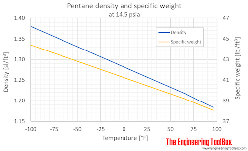

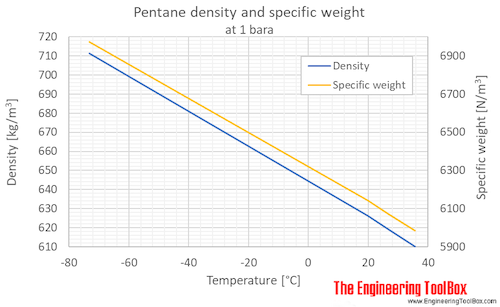

| Liquid | 200 | -73.2 | -99.7 | 0.1 | 1 | 14.5 | 9.858 | 711.3 | 44.40 | 1.380 | 6975 | 44.4 |
| 293 | 20.0 | 68.0 | 0.1 | 1 | 14.5 | 8.679 | 626.2 | 39.09 | 1.215 | 6141 | 39.1 | |
| 300 | 26.9 | 80.3 | 0.10 | 1 | 14.5 | 8.579 | 619.0 | 38.64 | 1.201 | 6070 | 38.6 | |
| 308.83 | 35.7 | 96.2 | 0.10 | 1 | 14.5 | 8.456 | 610.1 | 38.09 | 1.184 | 5983 | 38.1 | |
| Gas | 308.83 | 35.7 | 96.2 | 0.1 | 1 | 14.5 | 0.04073 | 2.939 | 0.1835 | 0.00570 | 28.8 | 0.183 |
| 400 | 127 | 260 | 0.1 | 1 | 14.5 | 0.03061 | 2.209 | 0.1379 | 0.00429 | 21.7 | 0.138 | |
| 500 | 227 | 440 | 0.1 | 1 | 14.5 | 0.02426 | 1.750 | 0.1093 | 0.00340 | 17.2 | 0.109 | |
| 200 | -73.2 | -99.7 | 0.1 | 1 | 14.5 | 0.02014 | 1.453 | 0.09069 | 0.00282 | 14.2 | 0.0907 | |
| Liquid | 200 | -73.2 | -99.7 | 1 | 10 | 145 | 9.866 | 711.8 | 44.44 | 1.381 | 6980 | 44.4 |
| 300 | 26.9 | 80.3 | 1 | 10 | 145 | 8.596 | 620.2 | 38.72 | 1.203 | 6082 | 38.7 | |
| 398.07 | 124.9 | 256.9 | 1 | 10 | 145 | 6.967 | 502.7 | 31.38 | 0.9753 | 4930 | 31.4 | |
| Gas | 398.07 | 124.9 | 256.9 | 1 | 10 | 145 | 0.3875 | 27.95 | 1.745 | 0.05424 | 274 | 1.75 |
| 400 | 127 | 260 | 1 | 10 | 145 | 0.3832 | 27.65 | 1.726 | 0.05364 | 271 | 1.73 | |
| 500 | 227 | 440 | 1 | 10 | 145 | 0.2638 | 19.03 | 1.188 | 0.03692 | 187 | 1.19 | |
| 600 | 327 | 620 | 1 | 10 | 145 | 0.2098 | 15.14 | 0.9450 | 0.02937 | 148 | 0.945 | |
| Liquid | 200 | -73.2 | -99.7 | 5 | 50 | 725 | 9.898 | 714.1 | 44.58 | 1.386 | 7003 | 44.6 |
| 300 | 26.9 | 80.3 | 5 | 50 | 725 | 8.665 | 625.2 | 39.03 | 1.213 | 6131 | 39.0 | |
| 400 | 127 | 260 | 5 | 50 | 725 | 7.161 | 516.7 | 32.25 | 1.003 | 5067 | 32.3 | |
Supercritical phase |
500 | 227 | 440 | 5 | 50 | 725 | 3.255 | 234.9 | 14.66 | 0.4557 | 2303 | 14.7 |
| 600 | 327 | 620 | 5 | 50 | 725 | 1.283 | 92.60 | 5.781 | 0.1797 | 908 | 5.78 | |
| Liquid | 200 | -73.2 | -99.7 | 10 | 100 | 1450 | 9.937 | 717.0 | 44.76 | 1.391 | 7031 | 44.8 |
| 300 | 26.9 | 80.3 | 10 | 100 | 1450 | 8.745 | 631.0 | 39.39 | 1.224 | 6188 | 39.4 | |
| 400 | 127 | 260 | 10 | 100 | 1450 | 7.379 | 532.4 | 33.24 | 1.033 | 5221 | 33.2 | |
500 | 227 | 440 | 10 | 100 | 1450 | 5.458 | 393.8 | 24.58 | 0.7641 | 3862 | 24.6 |
| 600 | 327 | 620 | 10 | 100 | 1450 | 3.077 | 222.0 | 13.86 | 0.4308 | 2177 | 13.9 | |
