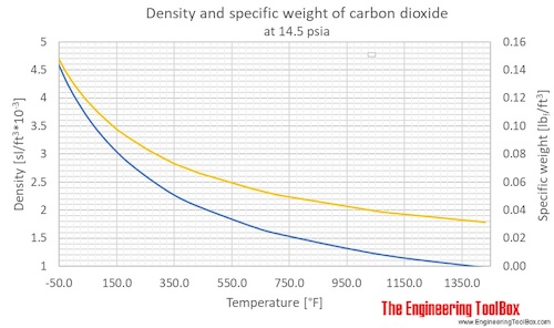

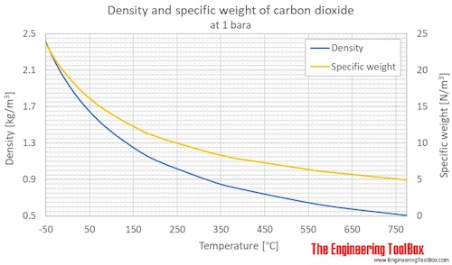

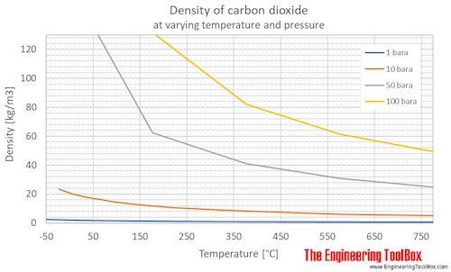

Carbon dioxide - Density and Specific Weight vs. Temperature and Pressure
Online calculator, figures and tables showing density and specific weight of carbon dioxide, CO2, at temperatures ranging from -50 to 775 °C (-50 to 1400 °F) at atmospheric and higher pressure - Imperial and SI Units.
ρ = m / V (1)
γ = (m g) / V
= ρ g (2)
Tabulated values of carbon dioxide density at given temperature and pressure (SI and Imperial units) as well as density units conversion are given below the figures.

| (K) | (°C) | (°F) | (MPa) | (bara) | (psia) | (mol/dm3) | (g/l) (kg/m3) | (lbm/ft3) | (sl/ft3 ×10-3) | (N/m3) | (lbf/ft3) | |
| Gas | 220 | -53.2 | -63.7 | 0.1 | 1 | 14.5 | 0.05542 | 2.439 | 0.1523 | 4.732 | 23.9 | 0.152 |
| 240 | -33.2 | -27.7 | 0.1 | 1 | 14.5 | 0.05063 | 2.228 | 0.1391 | 4.323 | 21.8 | 0.139 | |
| 250 | -23.2 | -9.7 | 0.1 | 1 | 14.5 | 0.04854 | 2.136 | 0.1334 | 4.145 | 21.0 | 0.133 | |
| 260 | -13.2 | 8.3 | 0.1 | 1 | 14.5 | 0.04663 | 2.052 | 0.1281 | 3.982 | 20.1 | 0.128 | |
| 280 | 6.9 | 44.3 | 0.1 | 1 | 14.5 | 0.04322 | 1.902 | 0.1187 | 3.690 | 18.7 | 0.119 | |
| 300 | 26.9 | 80.3 | 0.1 | 1 | 14.5 | 0.04029 | 1.773 | 0.1107 | 3.440 | 17.4 | 0.111 | |
| 320 | 47 | 116 | 0.1 | 1 | 14.5 | 0.03774 | 1.661 | 0.1037 | 3.223 | 16.3 | 0.104 | |
| 340 | 67 | 152 | 0.1 | 1 | 14.5 | 0.03549 | 1.562 | 0.09751 | 3.031 | 15.3 | 0.0975 | |
| 360 | 87 | 188 | 0.1 | 1 | 14.5 | 0.03349 | 1.474 | 0.09202 | 2.860 | 14.5 | 0.0920 | |
| 400 | 127 | 260 | 0.1 | 1 | 14.5 | 0.03013 | 1.326 | 0.08278 | 2.573 | 13.0 | 0.0828 | |
| 450 | 177 | 350 | 0.1 | 1 | 14.5 | 0.02658 | 1.170 | 0.07303 | 2.270 | 11.5 | 0.0730 | |
| 500 | 227 | 440 | 0.1 | 1 | 14.5 | 0.02406 | 1.059 | 0.06611 | 2.055 | 10.4 | 0.0661 | |
| 600 | 327 | 620 | 0.1 | 1 | 14.5 | 0.02005 | 0.8824 | 0.05509 | 1.712 | 8.65 | 0.0551 | |
| 650 | 377 | 710 | 0.1 | 1 | 14.5 | 0.01851 | 0.8144 | 0.05084 | 1.580 | 7.99 | 0.0508 | |
| 850 | 577 | 1070 | 0.1 | 1 | 14.5 | 0.01415 | 0.6226 | 0.03887 | 1.208 | 6.11 | 0.0389 | |
| 1050 | 777 | 1430 | 0.1 | 1 | 14.5 | 0.01145 | 0.5040 | 0.03146 | 0.978 | 4.94 | 0.0315 | |
| Gas | 233.03 | -40.1 | -40.2 | 1 | 10 | 145 | 0.5910 | 26.01 | 1.624 | 50.47 | 255 | 1.62 |
| 240 | -33.2 | -27.7 | 1 | 10 | 145 | 0.5649 | 24.86 | 1.552 | 48.24 | 244 | 1.55 | |
| 250 | -23.2 | -9.7 | 1 | 10 | 145 | 0.5325 | 23.44 | 1.463 | 45.47 | 230 | 1.46 | |
| 260 | -13.2 | 8.3 | 1 | 10 | 145 | 0.5047 | 22.21 | 1.387 | 43.09 | 218 | 1.39 | |
| 280 | 6.9 | 44.3 | 1 | 10 | 145 | 0.4590 | 20.20 | 1.261 | 39.19 | 198 | 1.26 | |
| 300 | 26.9 | 80.3 | 1 | 10 | 145 | 0.4222 | 18.58 | 1.160 | 36.05 | 182 | 1.16 | |
| 320 | 47 | 116 | 1 | 10 | 145 | 0.3915 | 17.23 | 1.076 | 33.43 | 169 | 1.08 | |
| 340 | 67 | 152 | 1 | 10 | 145 | 0.3656 | 16.09 | 1.004 | 31.22 | 158 | 1.00 | |
| 360 | 87 | 188 | 1 | 10 | 145 | 0.3433 | 15.11 | 0.9433 | 29.32 | 148 | 0.943 | |
| 400 | 127 | 260 | 1 | 10 | 145 | 0.3063 | 13.48 | 0.8415 | 26.16 | 132 | 0.842 | |
| 450 | 177 | 350 | 1 | 10 | 145 | 0.2704 | 11.90 | 0.7428 | 23.09 | 117 | 0.743 | |
| 500 | 227 | 440 | 1 | 10 | 145 | 0.2422 | 10.66 | 0.6655 | 20.68 | 105 | 0.665 | |
| 600 | 327 | 620 | 1 | 10 | 145 | 0.2010 | 8.845 | 0.5522 | 17.16 | 86.7 | 0.552 | |
| 650 | 377 | 710 | 1 | 10 | 145 | 0.1853 | 8.154 | 0.5090 | 15.82 | 80.0 | 0.509 | |
| 850 | 577 | 1070 | 1 | 10 | 145 | 0.1413 | 6.219 | 0.3882 | 12.07 | 61.0 | 0.388 | |
| 1050 | 777 | 1430 | 1 | 10 | 145 | 0.1143 | 5.030 | 0.3140 | 9.760 | 49.3 | 0.314 | |
| Liquid | 250 | -23.2 | -9.7 | 5 | 50 | 725 | 24.06 | 1059 | 66.10 | 2055 | 10384 | 66.1 |
| 287.43 | 14.3 | 57.7 | 5 | 50 | 725 | 18.80 | 827.3 | 51.65 | 1605 | 8113 | 51.6 | |
| Gas | 287.43 | 14.3 | 57.7 | 5 | 50 | 725 | 3.560 | 156.67 | 9.781 | 304.0 | 1536 | 9.78 |
| 450 | 177 | 350 | 5 | 50 | 725 | 1.416 | 62.30 | 3.889 | 120.9 | 611 | 3.89 | |
| 650 | 377 | 710 | 5 | 50 | 725 | 0.9298 | 40.92 | 2.555 | 79.40 | 401 | 2.55 | |
| 850 | 577 | 1070 | 5 | 50 | 725 | 0.7024 | 30.91 | 1.930 | 59.98 | 303 | 1.93 | |
| 1050 | 777 | 1430 | 5 | 50 | 725 | 0.5666 | 24.93 | 1.557 | 48.38 | 245 | 1.56 | |
| Liquid | 250 | -23.2 | -9.7 | 10 | 100 | 1450 | 24.46 | 1076 | 67.20 | 2089 | 10556 | 67.2 |
| Supercritical phase | 450 | 177 | 350 | 10 | 100 | 1450 | 2.991 | 131.6 | 8.218 | 255.4 | 1291 | 8.22 |
| 650 | 377 | 710 | 10 | 100 | 1450 | 1.863 | 82.00 | 5.119 | 159.1 | 804.1 | 5.12 | |
| 850 | 577 | 1070 | 10 | 100 | 1450 | 1.393 | 61.31 | 3.827 | 119.0 | 601 | 3.83 | |
| 1050 | 777 | 1430 | 10 | 100 | 1450 | 1.121 | 49.31 | 3.078 | 95.68 | 484 | 3.08 | |
| Supercritical phase | 250 | -23.2 | -9.7 | 100 | 1000 | 14504 | 28.08 | 1236 | 77.13 | 2397 | 12117 | 77.1 |
| 450 | 177 | 350 | 100 | 1000 | 14504 | 19.25 | 847.0 | 52.88 | 1643 | 8306 | 52.9 | |
| 650 | 377 | 710 | 100 | 1000 | 14504 | 13.68 | 601.9 | 37.58 | 1168 | 5903 | 37.6 | |
| 850 | 577 | 1070 | 100 | 1000 | 14504 | 10.64 | 468.1 | 29.22 | 908.2 | 4590 | 29.2 | |
| 1050 | 777 | 1430 | 100 | 1000 | 14504 | 8.793 | 387.0 | 24.16 | 750.8 | 3795 | 24.2 | |
