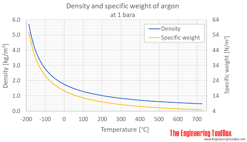

Online Argon Density Calculator
The calculator below can be used to estimate the density and specific weight of argon at given temperature and pressure.
The output density is given as kg/m3, lb/ft3, lb/gal(US liq) and sl/ft3. Specific weight is given as N/m3 and lbf/ft3.

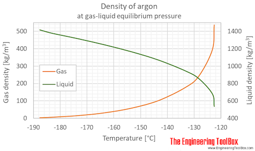

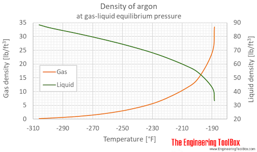

Density of argon at varying temperature and equilibrium pressure, SI and Imperial units:
