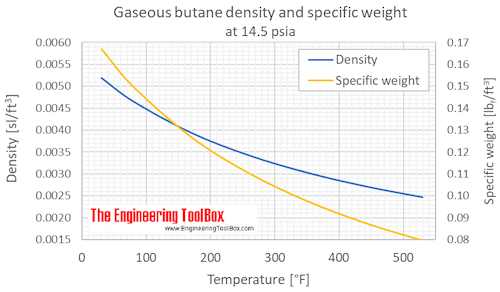

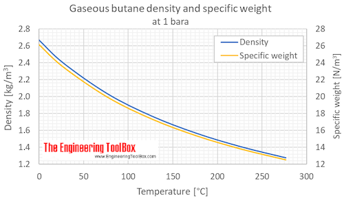

Density and specific weight of gaseous butane at varying temperature and atmospheric pressure, SI and Imperial units:

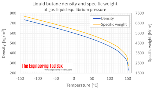

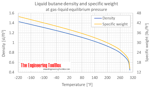

Density and specific weight of liquid butane at varying temperature and the gas-liquid equilibrium pressure, SI and Imperial units:

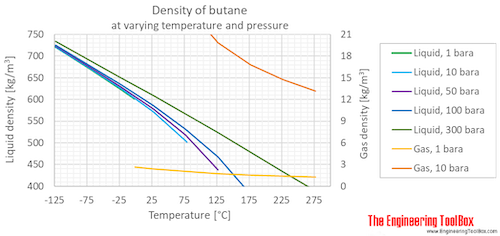

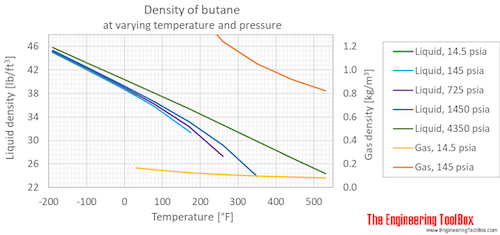

Density of butane at varying temperature and pressure, SI and Imperial units:
The density of liquid butane is nearly the same for all pressures up to 100 bara and 25 °C (77°F), and the density of the liquid at equilibrium pressure can be used for most practical purposes.

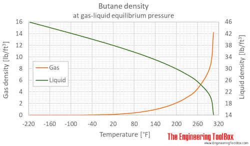

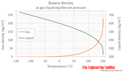

Density of butane at varying temperature and equilibrium pressure, SI and Imperial units:
