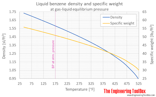

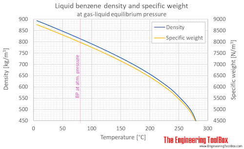

Note! Benzene boiling point at atmospheric pressure is 80 °C (176°F), and hence, benzene must be pressurized to remain liquid at higher temperatures than that.

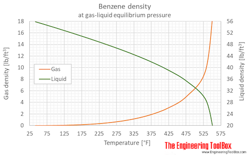

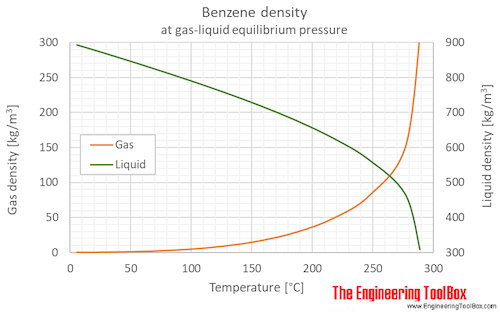

Density of benzene along the boiling and condensation curve, SI and Imperial units:
The density of liquid benzene is nearly the same for all pressures up to 100 bara, and the density of the liquid at equilibrium pressure can be used for most practical purposes.

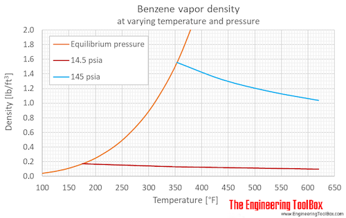

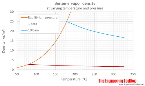

Density of benzene vapor (singel phase) at varying temperature and given pressures, SI and Imperial units:
