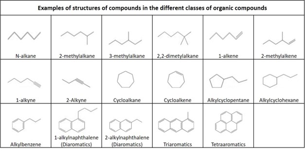

Below the table, examples of molecule structures for the different classes of hydrocarbons are given, together with a definition of the different classes of hydrocarbons.

| * Note that some of the substances have a melting point above 20°C, and that the given densities then are given for solid state. Superscript notations give measurement temperature(in °C) different from 20°C. | ||||||||||
Definition of organic compounds
Main groups of hydrocarbons:
Alkane: An acyclic saturated hydrocarbon, with the general formula CnH2n+2. Also called paraffin.
Alkene: An unsaturated hydrocarbon that contains at least one carbon–carbon double bond, with the general formula CnH2n. Also called olefin.
Alkyne: An unsaturated hydrocarbon containing at least one carbon—carbon triple bond, with the general formula CnH2n-2. Also called acetylenes.
Cycloalkane: A one-ring (monocyclic) saturated hydrocarbon, with the general formula CnH2n. Also called naphthene.
Cycloalkene: An alkene hydrocarbon which contains a closed ring of carbon atoms, but has no aromatic character, with the general formula CnH2n-2. Also called cycloolefin.
Aromatic hydrocarbon: A cyclic (ring-shaped), planar (flat) molecule with a ring of resonance bonds that exhibits more stability than other geometric or connective arrangements with the same set of atoms. The simplest of the aromatics have 6 carbon atoms and contains 3 double bounds. A one ring aromatic without any substituents is called benzene, with the formula C6H6.
Polycyclic aromatic hydrocarbons: hydrocarbon that are composed of multiple aromatic rings. A two ring aromatic without any substituents is called naphthalene, with the formula C10H8.
Some under-groups of hydrocarbons given in this document:
Alkyl: An alkyl group is an alkane substituent missing one hydrogen, with general formula CnH2n+1
Phenyl: An phenyl group is a benzene substituent missing one hydrogen, with general formula C6H5.
2-Methylalkane: A branched alkane, with a methyl group connected to the second carbon atom in the main carbon chain.
3-Methylalkane: A branched alkane, with a methyl group connected to the third carbon atom in the main carbon chain.
2-Methylalkene: A branched alkene, with a methyl group connected to the second carbon atom in the main carbon chain.
Alkylcycklohexane: A monosubstituted cyclohexane with one branching via the attachment of one alkyl group on one carbon of the cyclohexane ring, with the general formula CnH(2n+1)C6H11.
Alkylcycklopentane: A monosubstituted cyclopentane with one branching via the attachment of one alkyl group on one carbon of the cyclohexane ring, with the general formula CnH(2n+1)C5H9.
Alkylbenzene: A monosubstituted benzene with one branching via the attachment of one alkyl group on one carbon of the benzene ring, with the general formula CnH(2n+1)C6H5.
1-alkylnaphthalene: A monosubstituted naphthalene with one branching via the attachment of one alkyl group on one carbon of one of the aromatic rings, with the general formula CnH(2n+1)C10H7.
