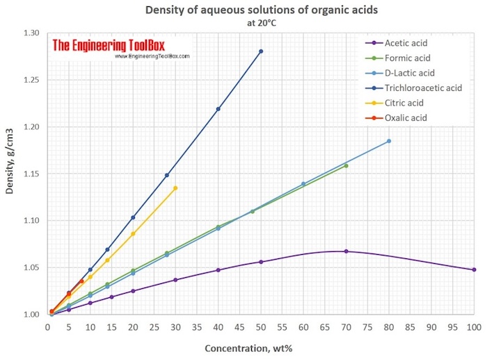

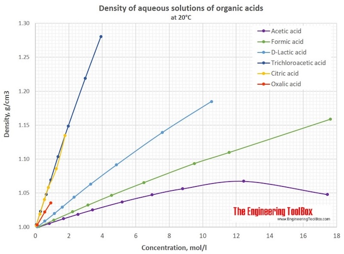

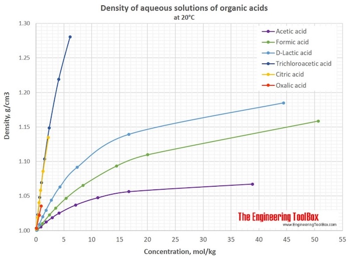

Changes in density of aqueous solutions with changes in concentration at 20°C. Density of acetic acid, citric acid, formic acid, D-lactic acid, oxalic acid and trichloroacetic acid in water is plotted as function of wt%, mol/kg water and mol/l solution.
Be aware of the concentration units in the figures:
wt%: Mass of solute/total mass of solution ×100%
mol/kg: Molality = moles of solute/kg of water
mol/liter: Molarity = moles of solute/liter of solution
Values are tabulated below the figures.

Density of aqueous solutions at 20°C, given as g/cm3:
For full table with Oxalic and Trichloreacetic Acid - rotate the screen!
Aqueous Solutions of Organic Acids - Densities
Mass%Acetic acidCitric acidFormic acidD-Lactic acidOxalic acidTrichloroacetic acid
1 0.9996 1.0022 1.0006 1.0002 1.0030 1.0034
5 1.0052 1.0189 1.0102 1.0086 1.0220 1.0230
10 1.0121 1.0402 1.0224 1.0199 1.0479
20 1.0250 1.0858 1.0467 1.0439 1.1035
30 1.0369 1.1346
40 1.0474 1.0935 1.0915 1.2188
50 1.0562 1.2803
60 1.1392
70 1.0673 1.1586
80 1.1848
100 1.0477
Density of acids solved in water at 20°C, given as wt%
Conversion of the concentration from mass% to mol/kg (moles of solute/kg of water = molality):
Aqueous Solutions of Organic Acids - Densities - Conversion of the concentration from mass% to mol/kg
1 0.168 0.053 0.219 0.112 0.112 0.062
5 0.876 0.274 1.143 0.584 0.585 0.322
10 1.850 0.578 2.414 1.233 0.680
20 4.163 1.301 5.410 2.775 1.530
30 7.137 2.231
40 11.102 14.483 7.401 4.080
50 16.653 6.120
60 16.652
70 38.857 50.692
80 44.405
Mol/kg solution at 20°C
Conversion of the concentration from mass% to mol/liter (moles of solute/liter of solution = molarity):
Aqueous Solutions of Organic Acids - Densities - Conversion of the concentration from mass% to mol/liter
1 0.166 0.052 0.217 0.111 0.111 0.061
5 0.837 0.265 1.097 0.560 0.568 0.313
10 1.685 0.541 2.221 1.132 0.641
20 3.414 1.254 4.548 2.318 1.351
30 5.180 1.772
40 6.977 9.502 4.847 2.984
50 8.794 3.918
60 7.588
70 12.441 17.619
80 10.522
100 17.447
Mol/liter solution at 20°C
