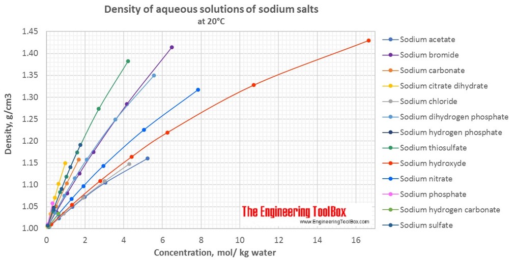

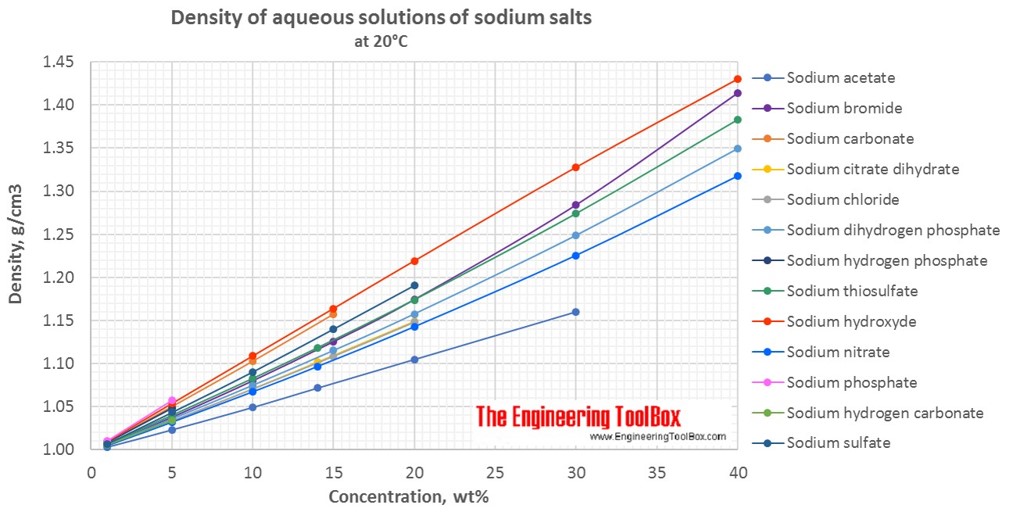

Densities of Aqueous Solutions of Inorganic Sodium Salts
Changes in density of aqueous solutions with changes in concentration at 20°C. Density of inorganic sodium salts in water is plotted as function of wt%, mol/kg water and mol/l solution.
Be aware of the concentration units in the figures:
wt%: Mass of solute/total mass of solution ×100%
mol/kg: Molality = moles of solute/kg of water
mol/liter: Molarity = moles of solute/liter of solution
Values are tabulated below the figures.

Density of aqueous solutions at 20°C, given as g/cm3:
Aqueous Solutions of Inorganic Sodium Salts - Densities
Mass%Sodium acetateSodium bromideSodium carbonateSodium chlorideSodium citrate dihydrateSodium dihydrogen phosphateSodium hydrogen carbonateSodium hydrogen phosphateSodium hydroxydeSodium nitrateSodium phosphateSodium sulfateSodium thiosulfate
1 1.0034 1.006 1.0086 1.0053 1.0049 1.0056 1.0054 1.0082 1.0095 1.005 1.01 1.0071 1.0065
5 1.0234 1.038 1.0502 1.034 1.0331 1.0358 1.0337 1.048 1.0538 1.0322 1.0579 1.0436 1.0399
10 1.0495 1.0803 1.1029 1.0707 1.0708 1.0747 1.1089 1.0674 1.0905 1.0827
20 1.1050 1.1745 1.1478 1.1492 1.1576 1.2192 1.1429 1.1907 1.174
30 1.1602 1.2842 1.2488 1.3277 1.2256 1.2739
40 1.4138 1.3493 1.4299 1.3175 1.3827
Density at 20°C, given as g/cm3
Conversion of the concentration from mass% to mol/kg (moles of solute/kg of water = molality):
Aqueous Solutions of Inorganic Sodium Salts - Densities - Conversion of the concentration from mass% to mol/kg
1 0.123 0.098 0.095 0.173 0.039 0.084 0.12 0.071 0.253 0.119 0.062 0.071 0.064
5 0.642 0.512 0.497 0.901 0.204 0.439 0.627 0.371 1.316 0.619 0.321 0.371 0.333
10 1.354 1.08 1.048 1.901 0.431 0.926 2.778 1.307 0.782 0.703
20 3.047 2.43 4.278 0.969 2.084 6.25 2.941 1.76 1.581
30 5.224 4.165 3.572 10.715 5.042 2.711
40 6.479 5.557 16.668 7.844 4.216
Molality at 20°C, given as mol/kg water
Conversion of the concentration from mass% to mol/liter (moles of solute/liter of solution = molarity):
Aqueous Solutions of Inorganic Sodium Salts - Densities - Conversion of the concentration from mass% to mol/liter
1 0.122 0.098 0.095 0.172 0.039 0.084 0.12 0.071 0.252 0.118 0.062 0.071 0.064
5 0.624 0.504 0.495 0.885 0.2 0.432 0.615 0.369 1.317 0.607 0.323 0.367 0.329
10 1.279 1.05 1.041 1.832 0.415 0.896 2.772 1.256 0.768 0.685
20 2.694 2.283 3.928 0.891 1.93 6.096 2.6989 1.677 1.485
30 4.243 3.744 3.123 9.958 4.326 2.417
40 5.496 4.499 14.3 6.2 3.48
Molarity at 20°C, given as mol/l solution
