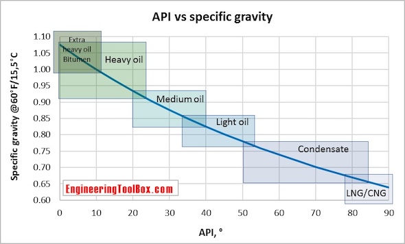

API_gravity
  • There is no clear definition of the different classes of crude oil; extra heavy oil (bitumen), heavy oil, medium oil, light oil, condensate. Different sources and different countries use their own limits. The boxes in the figure indicate the most common ranges used.
