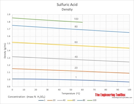

Sulfuric Acid - Density
Density of sulfuric acid at various temperatures and concentrations.
Sulfuric Acid Density - Concentration and Temperature
Concentration
(% mass H2SO4)
Density (g/mL)
Temperature (oC)
020406080100
1 1.0074 1.0051 0.9986 0.9895 0.9779 0.9646
20 1.1510 1.1394 1.1275 1.1153 1.1021 1.0885
40 1.3179 1.3028 1.2880 1.2732 1.2589 1.2446
60 1.5154 1.4983 1.4816 1.4656 1.4497 1.4344
80 1.7482 1.7272 1.7069 1.6873 1.6680 1.6493
100 1.8517 1.8305 1.8107 1.7922
