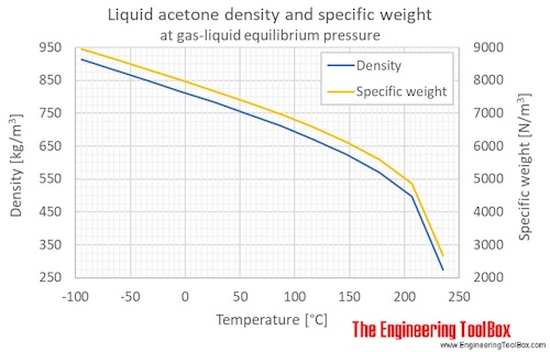

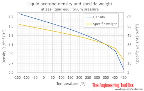

Tabulated values of acetone density and specific weight at given temperature and pressure (SI and Imperial units) as well as density units conversion are given below the figures.
Online Acetone Density Calculator
The calculator below can be used to estimate the density and specific weight of liquid acetone at given temperature at saturation pressure.

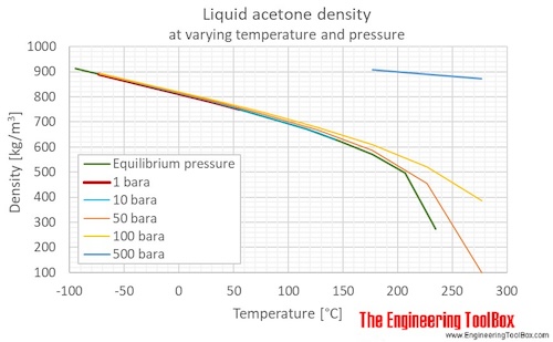

Density of liquid acetone at varying temperature (°C) and given pressures:
The density of liquid acetone is nearly the same for all pressures up to 100 bara for temperatures below 200°C/390°F, and the density of the liquid at equilibrium pressure (as used in the calculator above) can be used for most practical purposes.

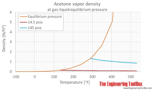

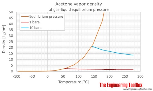

Density of acetone vapor (singel phase) at varying temperature and given pressures, SI and Imperial units:
