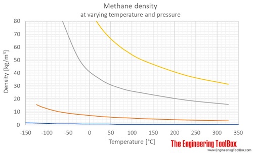

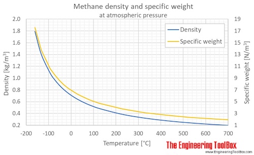

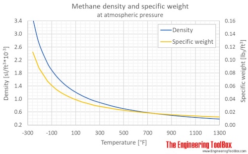

Tabulated values of methane density and specific weight at given temperature and pressure (SI and Imperial units) as well as density units conversion are given below the figures.

Density and specific weight of methane at given temperatures and pressures:
For full table with Density and Specific Weight- rotate the screen!
