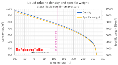

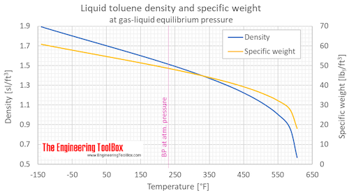

Density and specific weight of liquid toluene.
ρ = m / V (1)
γ = m g / V
= ρ g (2)
Tabulated values of toluene density and specific weight at given temperature and pressure (SI and Imperial units) as well as density units conversion are given below the figures.

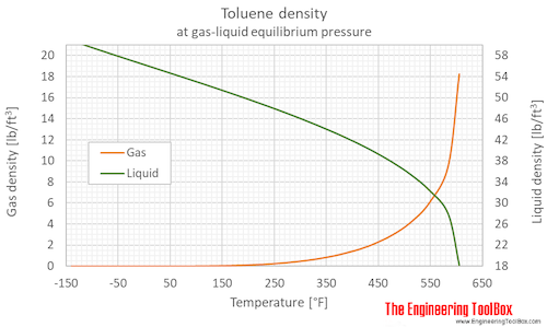

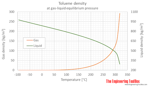

Density of t oluene along the boiling and condensation curve, SI and Imperial units:
The density of liquid toluene is nearly the same for all pressures up to 100 bara and 100 °C (212 °F), and the density of the liquid at equilibrium pressure can be used for most practical purposes.

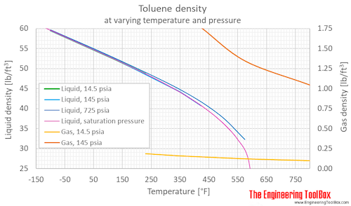

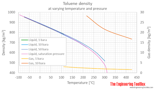

Density of toluene at varying temperature and given pressures, SI and Imperial units:
Density and specific weight of toluene at given temperatures and pressures:
