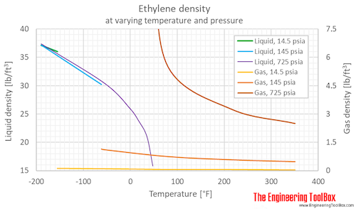

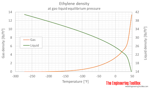

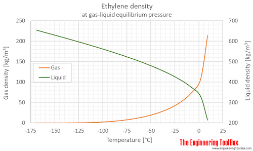

Density and specific weight of liquid ethylene at varying temperature and gas-liquid equilibrium pressure, SI and Imperial units:
Density of e thylene at varying temperature and pressure, SI and Imperial units:
Density of e thylene at varying temperature and equilibrium pressure, SI and Imperial units:
Density and specific weight of ethylene at given temperatures and pressures:
| State | Temperature | Pressure | Density | Specific weight | |||||||
| (K) | (°C) | (°F) | (bara) | (psia) | (mol/dm3) | (g/l), (kg/m3) | (lb/ft3) | (sl/ft3) | (N/m3) | (lbf/ft3) | |

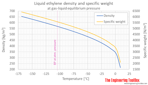

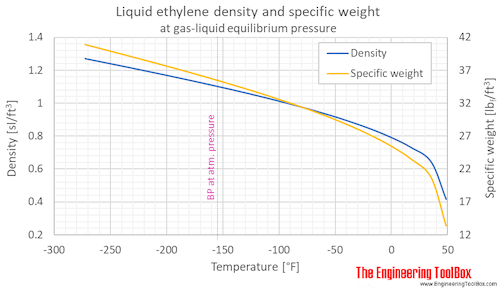

| Liquid at equilibrium |
103.99 | -169.16 | -272.49 | 1.22E-03 | 0.0177 | 23.33 | 654.6 | 40.86 | 1.270 | 6419 | 40.86 |
| 105 | -168 | -271 | 1.46E-03 | 0.0211 | 23.29 | 653.3 | 40.78 | 1.268 | 6407 | 40.78 | |
| 115 | -158 | -253 | 6.97E-03 | 0.101 | 22.83 | 640.6 | 39.99 | 1.243 | 6282 | 39.99 | |
| 125 | -148 | -235 | 0.0253 | 0.366 | 22.38 | 627.7 | 39.19 | 1.218 | 6156 | 39.19 | |
| 135 | -138 | -217 | 0.0739 | 1.07 | 21.91 | 614.6 | 38.37 | 1.193 | 6027 | 38.37 | |
| 145 | -128 | -199 | 0.183 | 2.66 | 21.44 | 601.3 | 37.54 | 1.167 | 5897 | 37.54 | |
| 155 | -118 | -181 | 0.398 | 5.77 | 20.95 | 587.8 | 36.69 | 1.140 | 5764 | 36.69 | |
| 165 | -108 | -163 | 0.777 | 11.3 | 20.46 | 573.9 | 35.82 | 1.113 | 5628 | 35.82 | |
| 175 | -98.2 | -145 | 1.39 | 20.2 | 19.95 | 559.5 | 34.93 | 1.086 | 5487 | 34.93 | |
| 185 | -88.2 | -127 | 2.33 | 33.9 | 19.42 | 544.7 | 34.01 | 1.057 | 5342 | 34.01 | |
| 195 | -78.2 | -109 | 3.69 | 53.5 | 18.87 | 529.2 | 33.04 | 1.027 | 5190 | 33.04 | |
| 205 | -68.2 | -90.7 | 5.56 | 80.7 | 18.29 | 513.0 | 32.02 | 0.9953 | 5031 | 32.02 | |
| 215 | -58.2 | -72.7 | 8.05 | 117 | 17.67 | 495.7 | 30.95 | 0.9619 | 4861 | 30.95 | |
| 225 | -48.2 | -54.7 | 11.3 | 164 | 17.01 | 477.2 | 29.79 | 0.9259 | 4680 | 29.79 | |
| 235 | -38.2 | -36.7 | 15.3 | 223 | 16.29 | 457.0 | 28.53 | 0.8868 | 4482 | 28.53 | |
| 245 | -28.2 | -18.7 | 20.4 | 296 | 15.49 | 434.5 | 27.12 | 0.8430 | 4261 | 27.12 | |
| 255 | -18.2 | -0.7 | 26.5 | 384 | 14.56 | 408.5 | 25.50 | 0.7925 | 4006 | 25.50 | |
| 265 | -8.1 | 17.3 | 33.9 | 492 | 13.42 | 376.4 | 23.50 | 0.7304 | 3692 | 23.50 | |
| 275 | 1.9 | 35.3 | 42.8 | 620 | 11.79 | 330.8 | 20.65 | 0.6419 | 3244 | 20.65 | |
| 282.35 | 9.20 | 48.56 | 50.4 | 731 | 7.637 | 214.2 | 13.37 | 0.4157 | 2101 | 13.37 | |

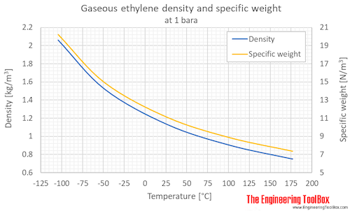

103.99 | -169.16 | -272.49 | 1.22E-03 | 0.0177 | 1.41E-04 | 3.96E-03 | 2.47E-04 | 7.68E-06 | 0.03881 | 2.47E-04 |
| 105 | -168 | -271 | 1.46E-03 | 0.0211 | 1.67E-04 | 4.68E-03 | 2.92E-04 | 9.08E-06 | 0.04592 | 2.92E-04 | |
| 115 | -158 | -253 | 6.97E-03 | 0.101 | 7.30E-04 | 0.02048 | 1.28E-03 | 3.97E-05 | 0.20083 | 1.28E-03 | |
| 125 | -148 | -235 | 0.0253 | 0.366 | 2.44E-03 | 0.06835 | 4.27E-03 | 1.33E-04 | 0.6702 | 4.27E-03 | |
| 135 | -138 | -217 | 0.0739 | 1.07 | 6.62E-03 | 0.1857 | 0.01159 | 3.60E-04 | 1.821 | 0.01159 | |
| 145 | -128 | -199 | 0.183 | 2.66 | 0.01533 | 0.4301 | 0.02685 | 8.35E-04 | 4.218 | 0.02685 | |
| 155 | -118 | -181 | 0.398 | 5.77 | 0.03138 | 0.8803 | 0.05495 | 1.71E-03 | 8.633 | 0.05495 | |
| 165 | -108 | -163 | 0.777 | 11.3 | 0.05823 | 1.634 | 0.1020 | 3.17E-03 | 16.02 | 0.1020 | |
| 175 | -98.2 | -145 | 1.39 | 20.2 | 0.1000 | 2.805 | 0.1751 | 5.44E-03 | 27.51 | 0.1751 | |
| 185 | -88.2 | -127 | 2.33 | 33.9 | 0.1614 | 4.528 | 0.2827 | 0.00879 | 44.41 | 0.2827 | |
| 195 | -78.2 | -109 | 3.69 | 53.5 | 0.2480 | 6.958 | 0.4344 | 0.01350 | 68.23 | 0.4344 | |
| 205 | -68.2 | -90.7 | 5.56 | 80.7 | 0.3664 | 10.28 | 0.6416 | 0.01994 | 100.8 | 0.6416 | |
| 215 | -58.2 | -72.7 | 8.05 | 117 | 0.5247 | 14.72 | 0.9189 | 0.02856 | 144.3 | 0.9189 | |
| 225 | -48.2 | -54.7 | 11.3 | 164 | 0.7339 | 20.59 | 1.285 | 0.03995 | 201.9 | 1.285 | |
| 235 | -38.2 | -36.7 | 15.3 | 223 | 1.009 | 28.31 | 1.767 | 0.05493 | 277.6 | 1.767 | |
| 245 | -28.2 | -18.7 | 20.4 | 296 | 1.375 | 38.56 | 2.408 | 0.07483 | 378.2 | 2.408 | |
| 255 | -18.2 | -0.7 | 26.5 | 384 | 1.872 | 52.51 | 3.278 | 0.1019 | 515.0 | 3.278 | |
| 265 | -8.1 | 17.3 | 33.9 | 492 | 2.589 | 72.62 | 4.533 | 0.1409 | 712.1 | 4.533 | |
| 275 | 1.9 | 35.3 | 42.8 | 620 | 3.795 | 106.5 | 6.646 | 0.2066 | 1044 | 6.646 | |

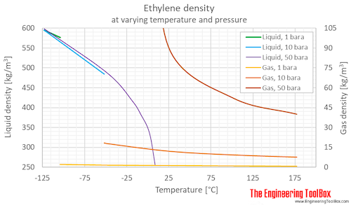

| Liquid | 150 | -123.2 | -190 | 1 | 14.5 | 21.20 | 594.6 | 37.12 | 1.154 | 5831 | 37.12 |
| 169.16 | -103.99 | -155.18 | 1 | 14.5 | 20.55 | 576.4 | 35.98 | 1.118 | 5652 | 35.98 | |

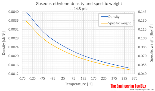

| Gas | 169.16 | -103.99 | -155.18 | 1 | 14.5 | 0.07352 | 2.062 | 0.1288 | 4.00E-03 | 20.23 | 0.1288 |
| 225 | -48.2 | -54.7 | 1 | 14.5 | 0.05418 | 1.520 | 0.09489 | 2.95E-03 | 14.91 | 0.09489 | |
| 300 | 26.9 | 80.3 | 1 | 14.5 | 0.04031 | 1.131 | 0.07060 | 2.19E-03 | 11.09 | 0.07059 | |
| 375 | 102 | 215 | 1 | 14.5 | 0.03216 | 0.9022 | 0.05632 | 1.75E-03 | 8.847 | 0.05632 | |
| 450 | 176.9 | 350 | 1 | 14.5 | 0.02676 | 0.7507 | 0.04686 | 1.46E-03 | 7.362 | 0.04686 | |
| Liquid | 150 | -123 | -190 | 10 | 145 | 21.22 | 595.3 | 37.16 | 1.155 | 5838 | 37.16 |
| 221.33 | -51.82 | -61.28 | 10 | 145 | 17.26 | 484.2 | 30.23 | 0.9395 | 4748 | 30.23 | |
| Gas | 221.33 | -51.82 | -61.28 | 10 | 145 | 0.6503 | 18.24 | 1.139 | 0.03540 | 178.9 | 1.139 |
| 225 | -48.2 | -54.7 | 10 | 145 | 0.6321 | 17.73 | 1.107 | 0.03441 | 173.9 | 1.107 | |
| 300 | 26.9 | 80.3 | 10 | 145 | 0.4254 | 11.93 | 0.7450 | 0.02316 | 117.0 | 0.7450 | |
| 375 | 102 | 215 | 10 | 145 | 0.3296 | 9.246 | 0.5772 | 0.01794 | 90.68 | 0.5772 | |
| 450 | 177 | 350 | 10 | 145 | 0.2710 | 7.602 | 0.4746 | 0.01475 | 74.55 | 0.4746 | |
| Liquid | 150 | -123 | -190 | 50 | 725 | 21.33 | 598.4 | 37.36 | 1.161 | 5868 | 37.36 |
| 225 | -48.2 | -54.7 | 50 | 725 | 17.36 | 487.0 | 30.40 | 0.9449 | 4776 | 30.40 | |
| 281.98 | 8.83 | 47.89 | 50 | 725 | 9.049 | 253.9 | 15.85 | 0.4926 | 2489 | 15.85 | |
| Gas | 281.98 | 8.83 | 47.89 | 50 | 725 | 6.241 | 175.1 | 10.93 | 0.3397 | 1717 | 10.93 |
| 300 | 26.9 | 80.3 | 50 | 725 | 3.128 | 87.75 | 5.478 | 0.1703 | 860.5 | 5.478 | |
| 375 | 102 | 215 | 50 | 725 | 1.859 | 52.15 | 3.256 | 0.1012 | 511.4 | 3.256 | |
| 450 | 177 | 350 | 50 | 725 | 1.430 | 40.12 | 2.504 | 0.07784 | 393.4 | 2.504 | |
| Liquid | 150 | -123.2 | -189.7 | 100 | 1450 | 21.46 | 602.0 | 37.58 | 1.168 | 5904 | 37.58 |
| 225 | -48.2 | -55 | 100 | 1450 | 17.74 | 497.7 | 31.07 | 0.9656 | 4880 | 31.07 | |
| Supercritical phase |
300 | 27 | 80 | 100 | 1450 | 11.51 | 322.9 | 20.16 | 0.6265 | 3166 | 20.16 |
| 375 | 102 | 215 | 100 | 1450 | 4.358 | 122.3 | 7.632 | 0.2372 | 1199 | 7.632 | |
| 450 | 177 | 350 | 100 | 1450 | 3.029 | 84.97 | 5.305 | 0.1649 | 833.3 | 5.305 | |
