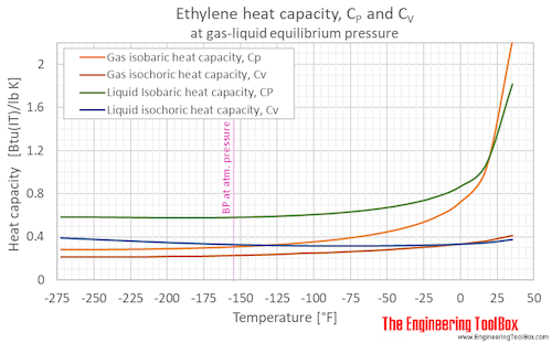

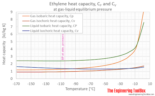

Isobaric, CP, and isochoric, CV, specific heat of ethylene at gas-liquid equilibrium pressure and varying temperature, °C and °F:
Ethylene specific heat Cp Cv equilibrium C
Ethylene specific heat Cp Cv equilibrium F

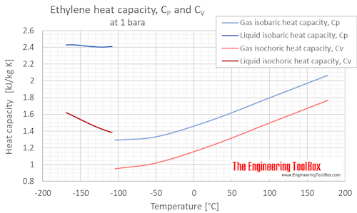

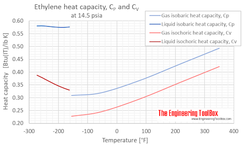

Isobaric, CP, and isochoric, CV, specific heat  of ethylene at atmospheric pressure and varying temperature, °C and °F:
Ethylene specific heat Cp Cv 1 bara C
Ethylene specific heat Cp Cv 1 bara F
