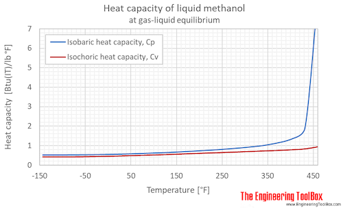

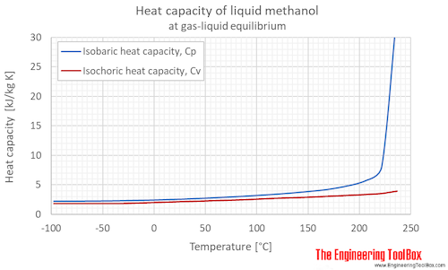

Isobaric, CP, and isochoric, CV, specific heat of methanol at gas-liquid equilibrium pressure, SI and Imperial units:

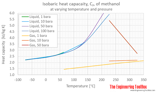

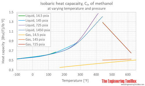

Isobaric specific heat, CP, of methanol at varying temperature and pressure, SI and Imperial units:

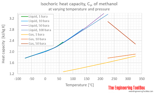

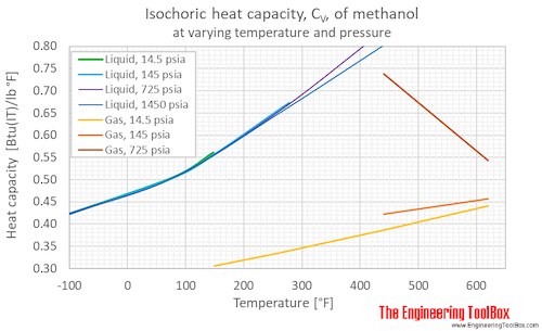

Isochoric specific heat, CV, of methanol at varying temperature and pressure, SI and Imperial units:
Isobaric specific heat, CP, of methanol at given temperatures and pressures:
For full table with Isobaric Specific Heat Units - rotate the screen!
| State | Temperature | Pressure | Isobaric Specific Heat, CP | Cp/Cv | ||||||||
| (K) | (°C) | (°F) | (MPa) | (bara) | (psia) | (kJ/mol K) | (kJ/kg K) | (Wh/(kg K)) | (kcal(IT)/(kg K)), (Btu(IT)/lb °F) | (Btu(IT)/(mol °F)) | (-) | |
Liquid at equilibrium |
175.61 | -97.54 | -143.57 | 1.86E-07 | 1.86E-06 | 2.70E-05 | 0.07039 | 2.197 | 0.6102 | 0.5247 | 0.03706 | 1.24 |
| 210 | -63.2 | -81.7 | 1.98E-05 | 1.98E-04 | 2.88E-03 | 0.07122 | 2.223 | 0.6174 | 0.5308 | 0.03750 | 1.25 | |
| 240 | -33.2 | -27.7 | 3.63E-04 | 3.63E-03 | 0.0527 | 0.07314 | 2.283 | 0.6341 | 0.5452 | 0.03851 | 1.23 | |
| 270 | -3.1 | 26.3 | 3.32E-03 | 0.0332 | 0.481 | 0.07648 | 2.387 | 0.6630 | 0.5701 | 0.04027 | 1.22 | |
| 298 | 25.0 | 77.0 | 0.0166 | 0.166 | 2.41 | 0.08120 | 2.534 | 0.7039 | 0.6053 | 0.04276 | 1.20 | |
| 300 | 26.9 | 80.3 | 0.0187 | 0.187 | 2.71 | 0.08158 | 2.546 | 0.7073 | 0.6081 | 0.04296 | 1.20 | |
| 330 | 56.9 | 134 | 0.0745 | 0.745 | 10.8 | 0.08851 | 2.762 | 0.7673 | 0.6597 | 0.04660 | 1.20 | |
| 360 | 86.9 | 188 | 0.230 | 2.30 | 33.3 | 0.09716 | 3.032 | 0.8423 | 0.7243 | 0.05116 | 1.22 | |
| 390 | 117 | 242 | 0.586 | 5.86 | 85.0 | 0.1078 | 3.363 | 0.9342 | 0.8033 | 0.05674 | 1.25 | |
| 420 | 147 | 296 | 1.29 | 12.9 | 187 | 0.1213 | 3.787 | 1.052 | 0.9044 | 0.06389 | 1.31 | |
| 450 | 177 | 350 | 2.54 | 25.4 | 369 | 0.1412 | 4.407 | 1.224 | 1.053 | 0.07435 | 1.43 | |
| 480 | 207 | 404 | 4.57 | 45.7 | 663 | 0.1835 | 5.725 | 1.590 | 1.367 | 0.09660 | 1.72 | |
| 495 | 97 | 207 | 5.98 | 59.8 | 867 | 0.2572 | 8.026 | 2.229 | 1.917 | 0.1354 | 2.29 | |
| 510 | 237 | 458 | 7.75 | 77.5 | 1124 | 1.109 | 34.60 | 9.612 | 8.265 | 0.5838 | 8.76 | |
Gas at equilibrium |
175.61 | -97.54 | -143.57 | 1.86E-07 | 1.86E-06 | 2.70E-05 | 0.04029 | 1.257 | 0.3493 | 0.3003 | 0.02121 | 1.26 |
| 210 | -63.2 | -81.7 | 1.98E-05 | 1.98E-04 | 2.88E-03 | 0.04939 | 1.541 | 0.4282 | 0.3682 | 0.02601 | 1.23 | |
| 240 | -33.2 | -27.7 | 3.63E-04 | 3.63E-03 | 0.0527 | 0.06797 | 2.121 | 0.5893 | 0.5067 | 0.03579 | 1.21 | |
| 270 | -3.1 | 26.3 | 3.32E-03 | 0.0332 | 0.481 | 0.09300 | 2.902 | 0.8062 | 0.6932 | 0.04897 | 1.21 | |
| 298 | 25.0 | 77.0 | 0.0166 | 0.166 | 2.41 | 0.1160 | 3.620 | 1.006 | 0.8647 | 0.06108 | 1.23 | |
| 300 | 26.9 | 80.3 | 0.0187 | 0.187 | 2.71 | 0.1174 | 3.664 | 1.018 | 0.8751 | 0.06182 | 1.23 | |
| 330 | 56.9 | 134 | 0.0745 | 0.745 | 10.8 | 0.1375 | 4.291 | 1.192 | 1.025 | 0.07240 | 1.27 | |
| 360 | 86.9 | 188 | 0.230 | 2.30 | 33.3 | 0.1556 | 4.856 | 1.349 | 1.160 | 0.08193 | 1.33 | |
| 390 | 117 | 242 | 0.586 | 5.86 | 85.0 | 0.1792 | 5.592 | 1.553 | 1.336 | 0.09434 | 1.43 | |
| 420 | 147 | 296 | 1.29 | 12.9 | 187 | 0.2199 | 6.862 | 1.906 | 1.639 | 0.1158 | 1.62 | |
| 450 | 177 | 350 | 2.54 | 25.4 | 369 | 0.2650 | 8.271 | 2.298 | 1.975 | 0.1395 | 1.86 | |
| 480 | 207 | 404 | 4.57 | 45.7 | 663 | 0.2796 | 8.726 | 2.424 | 2.084 | 0.1472 | 2.22 | |
| 495 | 222 | 431 | 5.98 | 59.8 | 867 | 0.4245 | 13.25 | 3.680 | 3.164 | 0.2235 | 3.37 | |
| 510 | 237 | 458 | 7.75 | 77.5 | 1124 | 1.910 | 59.60 | 16.55 | 14.23 | 1.006 | 14.4 | |
| Liquid | 200 | -73.2 | -99.7 | 0.1 | 1 | 14.5 | 0.07094 | 2.214 | 0.6150 | 0.5288 | 0.03736 | 1.25 |
| 300 | 26.9 | 80.3 | 0.1 | 1 | 14.5 | 0.08158 | 2.546 | 0.7072 | 0.6081 | 0.04296 | 1.20 | |
| 337.3 | 64.15 | 147.47 | 0.1 | 1 | 14.5 | 0.09045 | 2.823 | 0.7841 | 0.6742 | 0.04763 | 1.20 | |
| Gas | 337.3 | 64.15 | 147.47 | 0.1 | 1 | 14.5 | 0.1419 | 4.428 | 1.230 | 1.058 | 0.07470 | 1.28 |
| 400 | 127 | 260 | 0.1 | 1 | 14.5 | 0.05421 | 1.692 | 0.4699 | 0.4041 | 0.02854 | 1.21 | |
| 500 | 227 | 440 | 0.1 | 1 | 14.5 | 0.06038 | 1.884 | 0.5234 | 0.4501 | 0.03179 | 1.17 | |
| 600 | 327 | 620 | 0.1 | 1 | 14.5 | 0.06744 | 2.105 | 0.5847 | 0.5027 | 0.03551 | 1.14 | |
| Liquid | 200 | -73.2 | -99.7 | 1 | 10 | 145 | 0.07093 | 2.214 | 0.6149 | 0.5287 | 0.03735 | 1.25 |
| 300 | 26.9 | 80.3 | 1 | 10 | 145 | 0.08154 | 2.545 | 0.7069 | 0.6078 | 0.04294 | 1.20 | |
| 400 | 127 | 260 | 1 | 10 | 145 | 0.1118 | 3.488 | 0.9690 | 0.8331 | 0.05885 | 1.27 | |
| 409.75 | 136.60 | 277.88 | 1 | 10 | 145 | 0.1162 | 3.627 | 1.008 | 0.8664 | 0.06120 | 1.29 | |
| Gas | 409.75 | 136.60 | 277.88 | 1 | 10 | 145 | 0.2033 | 6.346 | 1.763 | 1.516 | 0.1071 | 1.54 |
| 500 | 227 | 440 | 1 | 10 | 145 | 0.06807 | 2.124 | 0.5901 | 0.5074 | 0.03584 | 1.20 | |
| 600 | 327 | 620 | 1 | 10 | 145 | 0.07037 | 2.196 | 0.6100 | 0.5245 | 0.03705 | 1.15 | |
| Liquid | 200 | -73.2 | -99.7 | 5 | 50 | 725 | 0.07088 | 2.212 | 0.6145 | 0.5284 | 0.03732 | 1.25 |
| 300 | 26.9 | 80.3 | 5 | 50 | 725 | 0.08138 | 2.540 | 0.7055 | 0.6066 | 0.04285 | 1.20 | |
| 400 | 127 | 260 | 5 | 50 | 725 | 0.1103 | 3.442 | 0.9561 | 0.8221 | 0.05807 | 1.26 | |
| 484.95 | 211.80 | 413.24 | 5 | 50 | 725 | 0.1984 | 6.191 | 1.720 | 1.479 | 0.1044 | 1.83 | |
| Gas | 484.95 | 211.80 | 413.24 | 5 | 50 | 725 | 0.3226 | 10.07 | 2.797 | 2.405 | 0.1699 | 2.58 |
| 500 | 227 | 440 | 5 | 50 | 725 | 0.1732 | 5.404 | 1.501 | 1.291 | 0.09117 | 1.75 | |
| 600 | 327 | 620 | 5 | 50 | 725 | 0.08749 | 2.730 | 0.7585 | 0.6522 | 0.04607 | 1.20 | |
| Liquid | 200 | -73.2 | -99.7 | 10 | 100 | 1450 | 0.07082 | 2.210 | 0.6140 | 0.5279 | 0.03729 | 1.24 |
| 300 | 26.9 | 80.3 | 10 | 100 | 1450 | 0.08120 | 2.534 | 0.7039 | 0.6052 | 0.04275 | 1.20 | |
| 400 | 127 | 260 | 10 | 100 | 1450 | 0.1088 | 3.396 | 0.9432 | 0.8110 | 0.05729 | 1.25 | |
| 500 | 227 | 440 | 10 | 100 | 1450 | 0.1896 | 5.917 | 1.644 | 1.413 | 0.09983 | 1.76 | |
| Supercritical phase |
600 | 327 | 620 | 10 | 100 | 1450 | 0.1212 | 3.783 | 1.051 | 0.9036 | 0.06383 | 1.36 |
| Liquid | 200 | -73.2 | -99.7 | 100 | 1000 | 14504 | 0.06899 | 2.153 | 0.5981 | 0.5143 | 0.03633 | 1.19 |
| 300 | 26.9 | 80.3 | 100 | 1000 | 14504 | 0.07982 | 2.491 | 0.6920 | 0.5950 | 0.04203 | 1.18 | |
| 400 | 127 | 260 | 100 | 1000 | 14504 | 0.09895 | 3.088 | 0.8578 | 0.7376 | 0.05210 | 1.19 | |
| 500 | 227 | 440 | 100 | 1000 | 14504 | 0.12152 | 3.793 | 1.053 | 0.9058 | 0.06399 | 1.27 | |
600 | 327 | 620 | 100 | 1000 | 14504 | 0.13787 | 4.303 | 1.195 | 1.028 | 0.07260 | 1.32 |
Isochoric specific heat, CV, of methanol at given temperatures and pressures:
For full table with Isochloric Specific Heat Units - rotate the screen!
| State | Temperature | Pressure | Isochoric Specific Heat, CV | ||||||||
| (K) | (°C) | (°F) | (MPa) | (bara) | (psia) | (kJ/mol K) | (kJ/kg K) | (Wh/(kg K)) | (kcal(IT)/(kg K)), (Btu(IT)/lb °F) | (Btu(IT)/(mol °F)) | |
175.61 | -97.54 | -143.57 | 1.86E-07 | 1.86E-06 | 2.70E-05 | 0.05673 | 1.770 | 0.4918 | 0.4229 | 0.02987 |
| 210 | -63.2 | -81.7 | 1.98E-05 | 1.98E-04 | 2.88E-03 | 0.05707 | 1.781 | 0.4948 | 0.4254 | 0.03005 | |
| 240 | -33.2 | -27.7 | 3.63E-04 | 3.63E-03 | 0.0527 | 0.05928 | 1.850 | 0.5139 | 0.4418 | 0.03121 | |
| 270 | -3.1 | 26.3 | 3.32E-03 | 0.0332 | 0.481 | 0.06292 | 1.964 | 0.5454 | 0.4690 | 0.03313 | |
| 298 | 25.0 | 77.0 | 0.0166 | 0.166 | 2.41 | 0.06750 | 2.107 | 0.5852 | 0.5032 | 0.03554 | |
| 300 | 26.9 | 80.3 | 0.0187 | 0.187 | 2.71 | 0.06786 | 2.118 | 0.5883 | 0.5059 | 0.03573 | |
| 330 | 56.9 | 134 | 0.0745 | 0.745 | 10.8 | 0.07367 | 2.299 | 0.6387 | 0.5492 | 0.03879 | |
| 360 | 86.9 | 188 | 0.230 | 2.30 | 33.3 | 0.07988 | 2.493 | 0.6925 | 0.5954 | 0.04206 | |
| 390 | 117 | 242 | 0.586 | 5.86 | 85.0 | 0.08619 | 2.690 | 0.7472 | 0.6425 | 0.04538 | |
| 420 | 147 | 296 | 1.29 | 12.9 | 187 | 0.09251 | 2.887 | 0.8020 | 0.6896 | 0.04871 | |
| 450 | 177 | 350 | 2.54 | 25.4 | 369 | 0.09903 | 3.091 | 0.8585 | 0.7382 | 0.05215 | |
| 480 | 207 | 404 | 4.57 | 45.7 | 663 | 0.1067 | 3.329 | 0.9247 | 0.7951 | 0.05616 | |
| 495 | 97 | 207 | 5.98 | 59.8 | 867 | 0.1125 | 3.511 | 0.9753 | 0.8386 | 0.05924 | |
| 510 | 237 | 458 | 7.75 | 77.5 | 1124 | 0.1265 | 3.949 | 1.097 | 0.9432 | 0.06663 | |
175.61 | -97.54 | -143.57 | 1.86E-07 | 1.86E-06 | 2.70E-05 | 0.03187 | 0.9948 | 0.2763 | 0.2376 | 0.01678 |
| 210 | -63.2 | -81.7 | 1.98E-05 | 1.98E-04 | 2.88E-03 | 0.04010 | 1.252 | 0.3477 | 0.2989 | 0.02112 | |
| 240 | -33.2 | -27.7 | 3.63E-04 | 3.63E-03 | 0.0527 | 0.05632 | 1.758 | 0.4883 | 0.4198 | 0.02966 | |
| 270 | -3.1 | 26.3 | 3.32E-03 | 0.0332 | 0.481 | 0.07706 | 2.405 | 0.6680 | 0.5744 | 0.04057 | |
| 298 | 25.0 | 77.0 | 0.0166 | 0.166 | 2.41 | 0.09450 | 2.949 | 0.8192 | 0.7044 | 0.04976 | |
| 300 | 26.9 | 80.3 | 0.0187 | 0.187 | 2.71 | 0.09558 | 2.983 | 0.8286 | 0.7125 | 0.05033 | |
| 330 | 56.9 | 134 | 0.0745 | 0.745 | 10.8 | 0.1086 | 3.389 | 0.9415 | 0.8095 | 0.05718 | |
| 360 | 86.9 | 188 | 0.230 | 2.30 | 33.3 | 0.1174 | 3.663 | 1.017 | 0.8748 | 0.06180 | |
| 390 | 117 | 242 | 0.586 | 5.86 | 85.0 | 0.1255 | 3.915 | 1.088 | 0.9352 | 0.06606 | |
| 420 | 147 | 296 | 1.29 | 12.9 | 187 | 0.1359 | 4.240 | 1.178 | 1.013 | 0.07154 | |
| 450 | 177 | 350 | 2.54 | 25.4 | 369 | 0.1424 | 4.444 | 1.234 | 1.061 | 0.07497 | |
| 480 | 207 | 404 | 4.57 | 45.7 | 663 | 0.1262 | 3.938 | 1.094 | 0.9406 | 0.06644 | |
| 495 | 222 | 431 | 5.98 | 59.8 | 867 | 0.1261 | 3.935 | 1.093 | 0.9398 | 0.06639 | |
| 510 | 237 | 458 | 7.75 | 77.5 | 1124 | 0.1326 | 4.138 | 1.149 | 0.9883 | 0.06982 | |
| Liquid | 200 | -73.2 | -99.7 | 0.1 | 1 | 14.5 | 0.05670 | 1.770 | 0.4916 | 0.4227 | 0.02986 |
| 300 | 26.9 | 80.3 | 0.1 | 1 | 14.5 | 0.06786 | 2.118 | 0.5883 | 0.5059 | 0.03573 | |
| 337.3 | 64.15 | 147.47 | 0.1 | 1 | 14.5 | 0.07516 | 2.346 | 0.6516 | 0.5603 | 0.03958 | |
| Gas | 337.3 | 64.15 | 147.47 | 0.1 | 1 | 14.5 | 0.1110 | 3.464 | 0.9623 | 0.8274 | 0.05845 |
| 400 | 127 | 260 | 0.1 | 1 | 14.5 | 0.04497 | 1.404 | 0.3899 | 0.3352 | 0.02368 | |
| 500 | 227 | 440 | 0.1 | 1 | 14.5 | 0.05182 | 1.617 | 0.4493 | 0.3863 | 0.02729 | |
| 600 | 327 | 620 | 0.1 | 1 | 14.5 | 0.05907 | 1.843 | 0.5120 | 0.4403 | 0.03110 | |
