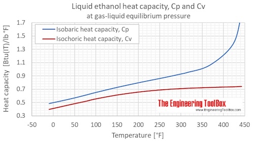

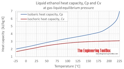

| Liquid | 250 | -23.2 | -9.7 | 0.000270 | 0.00270 | 0.0392 | 0.09361 | 2.032 | 0.000564 | 0.4853 | 0.04929 | 1.22 |
| 280 | 6.9 | 44.3 | 0.00258 | 0.0258 | 0.375 | 0.1083 | 2.351 | 0.000653 | 0.5614 | 0.05702 | 1.18 | |
| 298.2 | 25.0 | 77.0 | 0.0080 | 0.080 | 1.16 | 0.1184 | 2.570 | 0.000714 | 0.6138 | 0.06234 | 1.18 | |
| 310 | 36.9 | 98.3 | 0.0153 | 0.153 | 2.22 | 0.1252 | 2.719 | 0.000755 | 0.6493 | 0.06595 | 1.17 | |
| 340 | 66.9 | 152 | 0.0635 | 0.635 | 9.22 | 0.1412 | 3.064 | 0.000851 | 0.7318 | 0.07432 | 1.19 | |
| 370 | 96.9 | 206 | 0.2021 | 2.021 | 29.30 | 0.1554 | 3.374 | 0.000937 | 0.8058 | 0.08184 | 1.22 | |
| 400 | 127 | 260 | 0.5245 | 5.245 | 76.07 | 0.1688 | 3.665 | 0.00102 | 0.8753 | 0.08890 | 1.26 | |
| 423.9 | 151 | 303 | 1.000 | 10.00 | 145.0 | 0.1802 | 3.910 | 0.00109 | 0.9340 | 0.09486 | 1.31 | |
| 430 | 157 | 314 | 1.165 | 11.65 | 169.0 | 0.1834 | 3.981 | 0.00111 | 0.9509 | 0.09658 | 1.33 | |
| 460 | 187 | 368 | 2.292 | 22.92 | 332.4 | 0.2050 | 4.451 | 0.00124 | 1.063 | 0.1080 | 1.46 | |
| 490 | 217 | 422 | 4.095 | 40.95 | 594.0 | 0.2651 | 5.754 | 0.00160 | 1.374 | 0.1396 | 1.86 | |
| 501.4 | 228 | 443 | 5.000 | 50.00 | 725.2 | 0.3515 | 7.630 | 0.00212 | 1.822 | 0.1851 | 2.45 | |

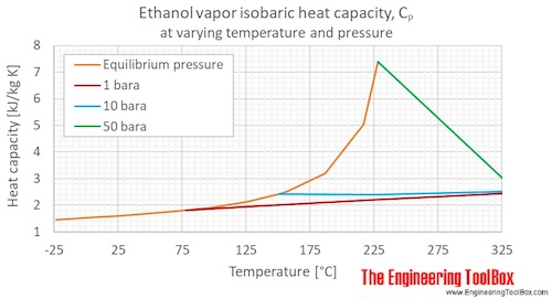

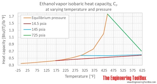

| Gas | 250 | -23.2 | -9.7 | 0.000270 | 0.00270 | 0.0392 | 0.06722 | 1.459 | 0.000405 | 0.3485 | 0.03539 | 1.14 |
| 280 | 6.9 | 44.3 | 0.00258 | 0.0258 | 0.375 | 0.07115 | 1.544 | 0.000429 | 0.3689 | 0.03746 | 1.13 | |
| 298.2 | 25.0 | 77.0 | 0.0080 | 0.0800 | 1.16 | 0.07380 | 1.602 | 0.000445 | 0.3826 | 0.03886 | 1.13 | |
| 310 | 36.9 | 98.3 | 0.0153 | 0.153 | 2.22 | 0.07546 | 1.638 | 0.000455 | 0.3912 | 0.03974 | 1.13 | |
| 340 | 66.9 | 152 | 0.0635 | 0.635 | 9.22 | 0.08074 | 1.753 | 0.000487 | 0.4186 | 0.04251 | 1.13 | |
| 370 | 96.9 | 206 | 0.2021 | 2.021 | 29.30 | 0.08806 | 1.911 | 0.000531 | 0.4565 | 0.04637 | 1.15 | |
| 400 | 127 | 260 | 0.5245 | 5.245 | 76.07 | 0.09894 | 2.148 | 0.000597 | 0.5129 | 0.05210 | 1.18 | |
| 423.9 | 151 | 303 | 1.000 | 10.00 | 145.0 | 0.1118 | 2.428 | 0.000674 | 0.5798 | 0.05889 | 1.24 | |
| 430 | 157 | 314 | 1.165 | 11.65 | 169.0 | 0.1161 | 2.520 | 0.000700 | 0.6019 | 0.06113 | 1.26 | |
| 460 | 187 | 368 | 2.292 | 22.92 | 332.4 | 0.1473 | 3.197 | 0.000888 | 0.7635 | 0.07755 | 1.43 | |
| 490 | 217 | 422 | 4.095 | 40.95 | 594.0 | 0.2320 | 5.036 | 0.00140 | 1.203 | 0.1222 | 1.98 | |
| 501.4 | 228 | 443 | 5.000 | 50.00 | 725.2 | 0.3410 | 7.402 | 0.00206 | 1.768 | 0.1796 | 2.75 | |
| Liquid | 300 | 26.9 | 80.3 | 0.1 | 1 | 14.5 | 0.1196 | 2.597 | 0.000721 | 0.6202 | 0.06299 | 1.17 |
| 351.1 | 77.9 | 172 | 0.1 | 1 | 14.5 | 0.1466 | 3.182 | 0.000884 | 0.7599 | 0.07718 | 1.20 | |
| Gas | 351.1 | 77.9 | 172 | 0.1 | 1 | 14.5 | 0.08313 | 1.804 | 0.000501 | 0.4310 | 0.04377 | 1.14 |
| 400 | 127 | 260 | 0.1 | 1 | 14.5 | 0.09000 | 1.954 | 0.000543 | 0.4666 | 0.04739 | 1.12 | |
| 500 | 227 | 440 | 0.1 | 1 | 14.5 | 0.1016 | 2.206 | 0.000613 | 0.5268 | 0.05351 | 1.09 | |
| 600 | 327 | 620 | 0.1 | 1 | 14.5 | 0.1125 | 2.442 | 0.000678 | 0.5834 | 0.05925 | 1.08 | |

| Gas | 423.9 | 151 | 303 | 1 | 10 | 145 | 0.1118 | 2.428 | 0.000674 | 0.5798 | 0.05889 | 1.24 |
| 500 | 227 | 440 | 1 | 10 | 145 | 0.1101 | 2.389 | 0.000664 | 0.5707 | 0.05796 | 1.14 | |
| 600 | 327 | 620 | 1 | 10 | 145 | 0.1161 | 2.519 | 0.000700 | 0.6017 | 0.06111 | 1.10 | |

| Gas | 501.4 | 228 | 443 | 5 | 50 | 725 | 0.3410 | 7.402 | 0.00206 | 1.768 | 0.1796 | 2.75 |
| 600 | 327 | 620 | 5 | 50 | 725 | 0.1366 | 2.965 | 0.000824 | 0.7082 | 0.07192 | 1.20 | |

Liquid at |
250 | -23.2 | -9.7 | 0.000270 | 0.00270 | 0.0392 | 0.07666 | 1.664 | 0.000462 | 0.3974 | 0.04036 | 1.22 |
| 280 | 6.9 | 44.3 | 0.00258 | 0.0258 | 0.375 | 0.09165 | 1.989 | 0.000553 | 0.4752 | 0.04826 | 1.18 | |
| 298.2 | 25.0 | 77.0 | 0.0080 | 0.080 | 1.16 | 0.1003 | 2.178 | 0.000605 | 0.5202 | 0.05283 | 1.18 | |
| 310 | 36.9 | 98.3 | 0.0153 | 0.153 | 2.22 | 0.1067 | 2.316 | 0.000643 | 0.5532 | 0.05618 | 1.17 | |
| 340 | 66.9 | 152 | 0.0635 | 0.635 | 9.22 | 0.1189 | 2.582 | 0.000717 | 0.6166 | 0.06262 | 1.19 | |
| 370 | 96.9 | 206 | 0.2021 | 2.021 | 29.30 | 0.1279 | 2.777 | 0.000771 | 0.6632 | 0.06736 | 1.22 | |
| 400 | 127 | 260 | 0.5245 | 5.245 | 76.07 | 0.1341 | 2.910 | 0.000808 | 0.6950 | 0.07059 | 1.26 | |
| 423.9 | 151 | 303 | 1.000 | 10.00 | 145.0 | 0.1373 | 2.981 | 0.000828 | 0.7119 | 0.07231 | 1.31 | |
| 430 | 157 | 314 | 1.165 | 11.65 | 169.0 | 0.1380 | 2.995 | 0.000832 | 0.7154 | 0.07265 | 1.33 | |
| 460 | 187 | 368 | 2.292 | 22.92 | 332.4 | 0.1404 | 3.048 | 0.000847 | 0.7280 | 0.07393 | 1.46 | |
| 490 | 217 | 422 | 4.095 | 40.95 | 594.0 | 0.1423 | 3.090 | 0.000858 | 0.7380 | 0.07495 | 1.86 | |
| 501.4 | 228 | 443 | 5.000 | 50.00 | 725.2 | 0.1434 | 3.113 | 0.000865 | 0.7435 | 0.07551 | 2.45 | |

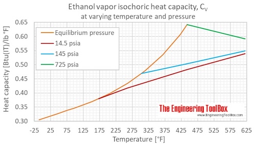

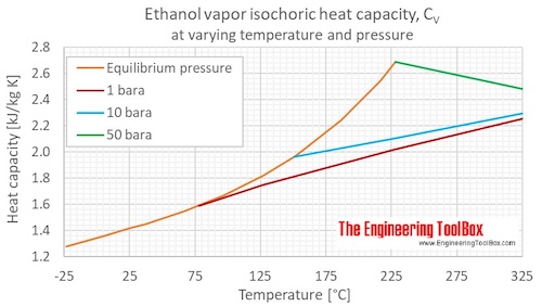

250 | -23.2 | -9.7 | 0.000270 | 0.00270 | 0.0392 | 0.05889 | 1.278 | 0.000355 | 0.3053 | 0.03101 | 1.14 |
| 280 | 6.9 | 44.3 | 0.00258 | 0.0258 | 0.375 | 0.06275 | 1.362 | 0.000378 | 0.3253 | 0.03304 | 1.13 | |
| 298.2 | 25.0 | 77.0 | 0.0080 | 0.080 | 1.16 | 0.06531 | 1.418 | 0.000394 | 0.3386 | 0.03439 | 1.13 | |
| 310 | 36.9 | 98.3 | 0.0153 | 0.153 | 2.22 | 0.06682 | 1.450 | 0.000403 | 0.3464 | 0.03518 | 1.13 | |
| 340 | 66.9 | 152 | 0.0635 | 0.635 | 9.22 | 0.07134 | 1.548 | 0.000430 | 0.3698 | 0.03756 | 1.13 | |
| 370 | 96.9 | 206 | 0.2021 | 2.021 | 29.30 | 0.07684 | 1.668 | 0.000463 | 0.3984 | 0.04046 | 1.15 | |
| 400 | 127 | 260 | 0.5245 | 5.245 | 76.07 | 0.08377 | 1.818 | 0.000505 | 0.4343 | 0.04411 | 1.18 | |
| 423.9 | 151 | 303 | 1.000 | 10.00 | 145.0 | 0.09052 | 1.965 | 0.000546 | 0.4693 | 0.04766 | 1.24 | |
| 430 | 157 | 314 | 1.165 | 11.65 | 169.0 | 0.09245 | 2.007 | 0.000557 | 0.4793 | 0.04868 | 1.26 | |
| 460 | 187 | 368 | 2.292 | 22.92 | 332.4 | 0.1032 | 2.241 | 0.000622 | 0.5352 | 0.05436 | 1.43 | |
| 490 | 217 | 422 | 4.095 | 40.95 | 594.0 | 0.1171 | 2.542 | 0.000706 | 0.6071 | 0.06165 | 1.98 | |
| 501.4 | 228 | 443 | 5.000 | 50.00 | 725.2 | 0.1239 | 2.689 | 0.000747 | 0.6423 | 0.06524 | 2.75 | |
| Liquid | 300 | 26.9 | 80.3 | 0.1 | 1 | 14.5 | 0.1019 | 2.213 | 0.000615 | 0.5285 | 0.05367 | 1.17 |
| 351.1 | 77.9 | 172 | 0.1 | 1 | 14.5 | 0.1226 | 2.661 | 0.000739 | 0.6357 | 0.06456 | 1.20 | |
| Gas | 351.1 | 77.9 | 172 | 0.1 | 1 | 14.5 | 0.07322 | 1.589 | 0.000441 | 0.3796 | 0.03856 | 1.14 |
| 400 | 127 | 260 | 0.1 | 1 | 14.5 | 0.08064 | 1.750 | 0.000486 | 0.4181 | 0.04246 | 1.12 | |
| 500 | 227 | 440 | 0.1 | 1 | 14.5 | 0.09291 | 2.017 | 0.000560 | 0.4817 | 0.04892 | 1.09 | |
| 600 | 327 | 620 | 0.1 | 1 | 14.5 | 0.10403 | 2.258 | 0.000627 | 0.5393 | 0.05478 | 1.08 | |
| Liquid | 300 | 26.9 | 80.3 | 1 | 10 | 145 | 0.1019 | 2.212 | 0.000614 | 0.5284 | 0.05366 | 1.17 |
| 400 | 127 | 260 | 1 | 10 | 145 | 0.1340 | 2.909 | 0.000808 | 0.6947 | 0.07056 | 1.26 | |
| 423.9 | 151 | 303 | 1 | 10 | 145 | 0.1373 | 2.981 | 0.000828 | 0.7119 | 0.07231 | 1.31 | |
| Gas | 423.9 | 151 | 303 | 1 | 10 | 145 | 0.09052 | 1.965 | 0.000546 | 0.4693 | 0.04766 | 1.24 |
| 500 | 227 | 440 | 1 | 10 | 145 | 0.09695 | 2.105 | 0.000585 | 0.5027 | 0.05105 | 1.14 | |
| 600 | 327 | 620 | 1 | 10 | 145 | 0.10581 | 2.297 | 0.000638 | 0.5486 | 0.05572 | 1.10 | |
| Liquid | 300 | 26.9 | 80.3 | 5 | 50 | 725 | 0.1019 | 2.211 | 0.000614 | 0.5280 | 0.05363 | 1.17 |
| 400 | 127 | 260 | 5 | 50 | 725 | 0.1336 | 2.900 | 0.000806 | 0.6926 | 0.07034 | 1.25 | |
| 501.4 | 228 | 443 | 5 | 50 | 725 | 0.1434 | 3.113 | 0.000865 | 0.7435 | 0.07551 | 2.45 | |
| Gas | 501.4 | 228 | 443 | 5 | 50 | 725 | 0.1239 | 2.689 | 0.000747 | 0.6423 | 0.06524 | 2.75 |
| 600 | 327 | 620 | 5 | 50 | 725 | 0.1142 | 2.479 | 0.000689 | 0.5920 | 0.06013 | 1.20 | |
