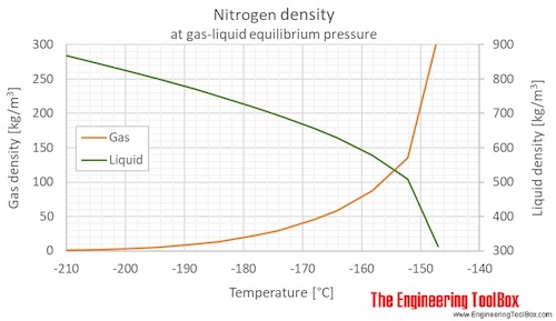

Tabulated values of nitrogen density at given temperature and pressure (SI and Imperial units) as well as density units conversion are given below the figures.

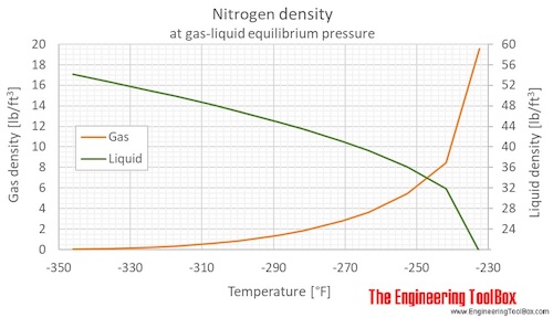

Liquid at equilibrium pressure |
63.15 | -210.0 | -346.0 | 0.013 | 0.125 | 1.82 | 30.96 | 867.2 | 54.14 | 1683 | 8505 | 54.1 |
| 69 | -204 | -335 | 0.033 | 0.332 | 4.82 | 30.09 | 842.8 | 52.61 | 1635 | 8265 | 52.6 | |
| 75 | -198 | -325 | 0.076 | 0.760 | 11.0 | 29.15 | 816.7 | 50.98 | 1585 | 8009 | 51.0 | |
| 79 | -194 | -317 | 0.122 | 1.22 | 17.8 | 28.51 | 798.6 | 49.85 | 1549 | 7831 | 49.9 | |
| 85 | -188 | -307 | 0.229 | 2.29 | 33.2 | 27.49 | 770.2 | 48.08 | 1494 | 7553 | 48.1 | |
| 89 | -184 | -299 | 0.331 | 3.31 | 47.9 | 26.78 | 750.2 | 46.83 | 1456 | 7357 | 46.8 | |
| 95 | -178 | -289 | 0.541 | 5.41 | 78.4 | 25.64 | 718.3 | 44.84 | 1394 | 7044 | 44.8 | |
| 99 | -174 | -281 | 0.726 | 7.26 | 105 | 24.82 | 695.4 | 43.41 | 1349 | 6819 | 43.4 | |
| 105 | -168 | -271 | 1.08 | 10.8 | 157 | 23.47 | 657.5 | 41.05 | 1276 | 6448 | 41.0 | |
| 109 | -164 | -263 | 1.38 | 13.8 | 201 | 22.46 | 629.1 | 39.27 | 1221 | 6169 | 39.3 | |
| 115 | -158 | -253 | 1.94 | 19.4 | 281 | 20.66 | 578.7 | 36.13 | 1123 | 5675 | 36.1 | |
| 121 | -152 | -242 | 2.64 | 26.4 | 383 | 18.19 | 509.5 | 31.81 | 988.6 | 4996 | 31.8 | |
| 126.2 | -147.0 | -232.5 | 3.40 | 34.0 | 493 | 11.18 | 313.3 | 19.56 | 607.9 | 3073 | 19.6 | |
Gas at equlibrium pressure |
63.15 | -210.0 | -346.0 | 0.013 | 0.125 | 1.82 | 0.02407 | 0.6743 | 0.04210 | 1.308 | 6.61 | 0.0421 |
| 69 | -204 | -335 | 0.033 | 0.332 | 4.82 | 0.05903 | 1.654 | 0.1032 | 3.209 | 16.2 | 0.103 | |
| 75 | -198 | -325 | 0.076 | 0.760 | 11.0 | 0.1264 | 3.540 | 0.2210 | 6.870 | 34.7 | 0.221 | |
| 79 | -194 | -317 | 0.122 | 1.22 | 17.8 | 0.1961 | 5.494 | 0.3430 | 10.66 | 53.9 | 0.343 | |
| 85 | -188 | -307 | 0.229 | 2.29 | 33.2 | 0.3507 | 9.824 | 0.6133 | 19.06 | 96.3 | 0.613 | |
| 89 | -184 | -299 | 0.331 | 3.31 | 47.9 | 0.4958 | 13.89 | 0.8670 | 26.95 | 136 | 0.867 | |
| 95 | -178 | -289 | 0.541 | 5.41 | 78.4 | 0.7950 | 22.27 | 1.390 | 43.22 | 218 | 1.39 | |
| 99 | -174 | -281 | 0.726 | 7.26 | 105 | 1.063 | 29.79 | 1.860 | 57.80 | 292 | 1.86 | |
| 105 | -168 | -271 | 1.08 | 10.8 | 157 | 1.605 | 44.96 | 2.807 | 87.24 | 441 | 2.81 | |
| 109 | -164 | -263 | 1.38 | 13.8 | 201 | 2.092 | 58.59 | 3.658 | 113.7 | 575 | 3.66 | |
| 115 | -158 | -253 | 1.94 | 19.4 | 281 | 3.116 | 87.30 | 5.450 | 169.4 | 856 | 5.45 | |
| 121 | -152 | -242 | 2.64 | 26.4 | 383 | 4.838 | 135.5 | 8.461 | 263.0 | 1329 | 8.46 | |

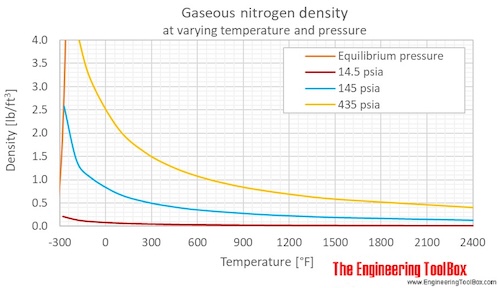

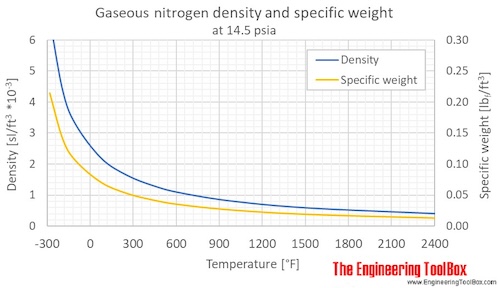

| Gas | 100 | -173 | -280 | 0.1 | 1 | 14.5 | 0.1227 | 3.437 | 0.2145 | 6.668 | 33.7 | 0.215 |
| 150 | -123 | -190 | 0.1 | 1 | 14.5 | 0.08040 | 2.252 | 0.1406 | 4.370 | 22.1 | 0.141 | |
| 200 | -73.2 | -99.7 | 0.1 | 1 | 14.5 | 0.06030 | 1.689 | 0.1055 | 3.278 | 16.6 | 0.105 | |
| 300 | 26.9 | 80.3 | 0.1 | 1 | 14.5 | 0.04020 | 1.126 | 0.07030 | 2.185 | 11.0 | 0.0703 | |
| 400 | 127 | 260 | 0.1 | 1 | 14.5 | 0.03015 | 0.845 | 0.05273 | 1.639 | 8.28 | 0.0527 | |
| 500 | 227 | 440 | 0.1 | 1 | 14.5 | 0.02412 | 0.676 | 0.04218 | 1.311 | 6.63 | 0.0422 | |
| 600 | 327 | 620 | 0.1 | 1 | 14.5 | 0.02004 | 0.561 | 0.03504 | 1.089 | 5.50 | 0.0350 | |
| 800 | 527 | 980 | 0.1 | 1 | 14.5 | 0.01507 | 0.422 | 0.02636 | 0.8194 | 4.14 | 0.0264 | |
| 1100 | 827 | 1520 | 0.1 | 1 | 14.5 | 0.01093 | 0.306 | 0.01912 | 0.5941 | 3.00 | 0.0191 | |
| 1600 | 1327 | 2420 | 0.1 | 1 | 14.5 | 0.00752 | 0.211 | 0.01314 | 0.4085 | 2.06 | 0.0131 | |

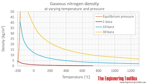

| Liquid | 100 | -173 | -280 | 1 | 10 | 145 | 24.66 | 690.8 | 43.12 | 1340 | 6774 | 43.1 |
| 103.8 | -169.4 | -272.9 | 1 | 10 | 145 | 23.77 | 665.8 | 41.57 | 1292 | 6530 | 41.6 | |
| Gas | 103.8 | -169.4 | -272.9 | 1 | 10 | 145 | 1.475 | 41.33 | 2.580 | 80.20 | 405 | 2.58 |
| 150 | -123 | -190 | 1 | 10 | 145 | 0.8015 | 22.45 | 1.402 | 43.57 | 220 | 1.40 | |
| 200 | -73.2 | -99.7 | 1 | 10 | 145 | 0.6011 | 16.84 | 1.051 | 32.68 | 165 | 1.05 | |
| 300 | 26.9 | 80.3 | 1 | 10 | 145 | 0.4008 | 11.23 | 0.7009 | 21.78 | 110 | 0.701 | |
| 400 | 127 | 260 | 1 | 10 | 145 | 0.3006 | 8.420 | 0.5257 | 16.34 | 82.6 | 0.526 | |
| 500 | 227 | 440 | 1 | 10 | 145 | 0.2405 | 6.736 | 0.4205 | 13.07 | 66.1 | 0.421 | |
| 600 | 327 | 620 | 1 | 10 | 145 | 0.1996 | 5.592 | 0.3491 | 10.85 | 54.8 | 0.349 | |
| 800 | 527 | 980 | 1 | 10 | 145 | 0.1503 | 4.210 | 0.2628 | 8.169 | 41.3 | 0.263 | |
| 950 | 677 | 1250 | 1 | 10 | 145 | 0.1266 | 3.545 | 0.2213 | 6.879 | 34.8 | 0.221 | |
| 1100 | 827 | 1520 | 1 | 10 | 145 | 0.1090 | 3.053 | 0.1906 | 5.924 | 29.9 | 0.191 | |
| 1600 | 1327 | 2420 | 1 | 10 | 145 | 0.07499 | 2.101 | 0.1312 | 4.076 | 20.6 | 0.131 | |
| Gas | 150 | -123 | -190 | 3 | 30 | 435 | 2.405 | 67.36 | 4.205 | 130.7 | 661 | 4.21 |
| 200 | -73.2 | -99.7 | 3 | 30 | 435 | 1.803 | 50.52 | 3.154 | 98.03 | 495 | 3.15 | |
| 300 | 26.9 | 80.3 | 3 | 30 | 435 | 1.202 | 33.68 | 2.103 | 65.35 | 330 | 2.10 | |
| 400 | 127 | 260 | 3 | 30 | 435 | 0.9017 | 25.26 | 1.577 | 49.01 | 248 | 1.58 | |
| 500 | 227 | 440 | 3 | 30 | 435 | 0.7214 | 20.21 | 1.262 | 39.21 | 198 | 1.26 | |
| 600 | 327 | 620 | 3 | 30 | 435 | 0.6011 | 16.84 | 1.051 | 32.68 | 165 | 1.05 | |
| 700 | 427 | 800 | 3 | 30 | 435 | 0.5153 | 14.43 | 0.9011 | 28.01 | 142 | 0.901 | |
| 800 | 527 | 980 | 3 | 30 | 435 | 0.4509 | 12.63 | 0.7885 | 24.51 | 124 | 0.788 | |
| 950 | 677 | 1250 | 3 | 30 | 435 | 0.3797 | 10.64 | 0.6640 | 20.64 | 104 | 0.664 | |
| 1100 | 827 | 1520 | 3 | 30 | 435 | 0.3279 | 9.186 | 0.5734 | 17.82 | 90.1 | 0.573 | |
| 1600 | 1327 | 2420 | 3 | 30 | 435 | 0.2254 | 6.315 | 0.3942 | 12.25 | 61.9 | 0.394 | |
| Liquid | 100 | -173 | -280 | 5 | 50 | 725 | 25.44 | 712.6 | 44.48 | 1383 | 6988 | 44.5 |
Supercritical phase |
150 | -123 | -190 | 5 | 50 | 725 | 4.008 | 112.3 | 7.009 | 217.8 | 1101 | 7.01 |
| 200 | -73.2 | -99.7 | 5 | 50 | 725 | 3.006 | 84.20 | 5.257 | 163.4 | 826 | 5.26 | |
| 300 | 26.9 | 80.3 | 5 | 50 | 725 | 2.004 | 56.13 | 3.504 | 108.9 | 550 | 3.50 | |
| 400 | 127 | 260 | 5 | 50 | 725 | 1.503 | 42.10 | 2.628 | 81.69 | 413 | 2.63 | |
| 500 | 227 | 440 | 5 | 50 | 725 | 1.202 | 33.68 | 2.103 | 65.35 | 330 | 2.10 | |
| 600 | 327 | 620 | 5 | 50 | 725 | 0.9808 | 27.48 | 1.715 | 53.31 | 269 | 1.72 | |
| 1100 | 827 | 1520 | 5 | 50 | 725 | 0.5380 | 15.07 | 0.941 | 29.24 | 148 | 0.941 | |
| 1600 | 1327 | 2420 | 5 | 50 | 725 | 0.3715 | 10.41 | 0.650 | 20.19 | 102 | 0.650 | |
| Liquid | 100 | -173 | -280 | 10 | 100 | 1450 | 26.19 | 733.6 | 45.80 | 1423 | 7194 | 45.8 |
150 | -123 | -190 | 10 | 100 | 1450 | 8.015 | 224.5 | 14.02 | 435.7 | 2202 | 14.0 |
| 200 | -73.2 | -99.7 | 10 | 100 | 1450 | 6.011 | 168.4 | 10.51 | 326.8 | 1651 | 10.5 | |
| 300 | 26.9 | 80.3 | 10 | 100 | 1450 | 4.008 | 112.3 | 7.009 | 217.8 | 1101 | 7.01 | |
| 400 | 127 | 260 | 10 | 100 | 1450 | 3.006 | 84.20 | 5.257 | 163.4 | 826 | 5.26 | |
| 500 | 227 | 440 | 10 | 100 | 1450 | 2.405 | 67.36 | 4.205 | 130.7 | 661 | 4.21 | |
| 600 | 327 | 620 | 10 | 100 | 1450 | 1.918 | 53.74 | 3.355 | 104.3 | 527 | 3.35 | |
| 1100 | 827 | 1520 | 10 | 100 | 1450 | 1.059 | 29.67 | 1.852 | 57.56 | 291 | 1.85 | |
| 1600 | 1327 | 2420 | 10 | 100 | 1450 | 0.7344 | 20.57 | 1.284 | 39.92 | 202 | 1.28 | |
