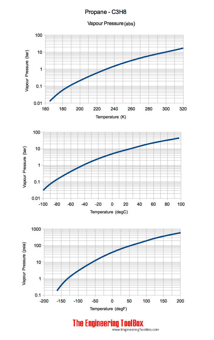

Vapor pressure vs. temperature.
The vapor pressure of propane (C3H8) depends on the temperature. Vapor pressure of 100% propane:
propane temperature pressure vapor diagram
Note! The metric chart indicates gauge pressure. The Imperial chart indicates absolute pressure . Imperial gauge pressure can be calculated as
psig = psia - (14.7 psi)                     (1)
