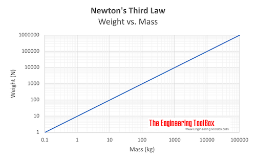

Example - Force due to Gravity (Weight)
Apple and acceleration of gravity - mass and weight
The gravity force - weight - on a apple with mass 50 g (0.050 kg) due to acceleration of gravity ag = 9.81 m/s2 - can be calculated as
F = (0.050 kg) (9.81 m/s2)
= 0.4905 N

The calculator below can used to calculate force due to mass and acceleration:
Newton's third law - weight (force) vs. mass
