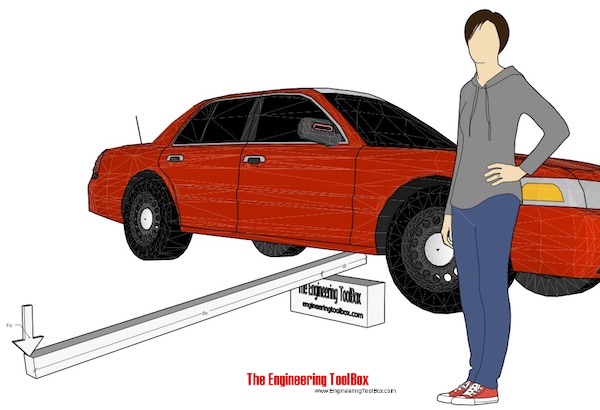

Example - Improvised Car Lift
Improvised car lift lever
An improvised car lift can be made with a piece of lumber as illustrated in the figure above. With distance load to fulcrum 0.2 m, distance effort force to fulcrum 2 m and a load on the lever - half the weight of the car 2000 kg - the effort force can be calculated
Fe = (0.5 2000 kg) (9.81 m/s2) (0.2 m) / (2 m)
    = 981 N
    ≈ 100 kg
