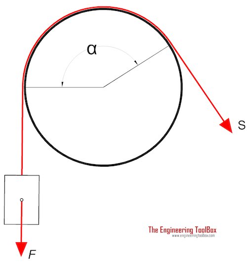

Bollard - load and effort force
The effort force in a rope around a bollard can be calculated as
S = F e-(μ αrad )                      (1)
S = effort force in the rope (N, lb)
F = load force (N, lbf)
e = 2.718..
μ = friction coefficient (approximately 0.3 - 0.5 is common for a rope around a steel or cast iron bollard)
αrad = 2 π αdegrees / 360 = angle where the rope is in contact with the bollard (radians)
αdegrees = angle where the rope is in contact with the bollard (degrees)

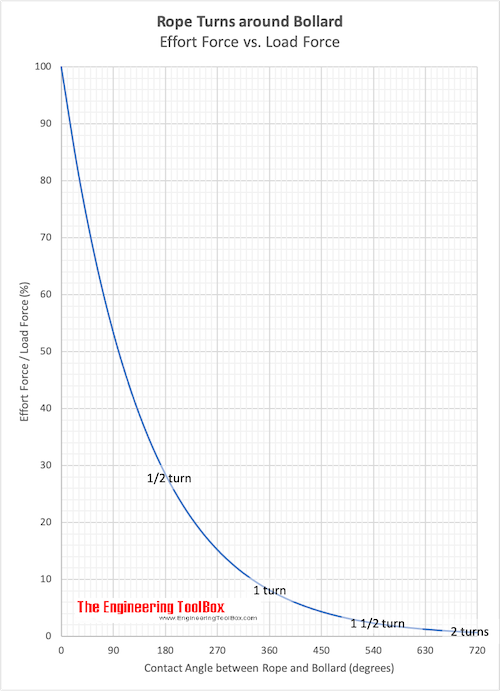

The Effort Force - Load Force ratio for various rope angles are indicated in the chart below. Note that one turn - 3600 - reduces the required effort force to approximately 10% of the load.
Bollard - rope effort versus load force when mooring a ship - chart
Download and print Rope Turns around Bollard Effort Force vs. Load Force Chart
