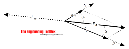

Trigonometric Calculation
Vector addition - cosine rule
The resulting vector of two coplanar vector can be calculated by trigonometry using "the cosine rule" for a non-right-angled triangle.
FR = (F12 + F22 − 2 F1 F2 cos(180o - (α + β)))1/2                          (1)
F = the vector quantity - force, velocity etc.
α + β = angle between vector 1 and 2
The angle between the vector and the resulting vector can be calculated using "the sine rule" for a non-right-angled triangle.
α = sin-1(Fsin(180o - (α + β)) / FR)                                     (2)
α + β = the angle between vector 1 and 2 is known

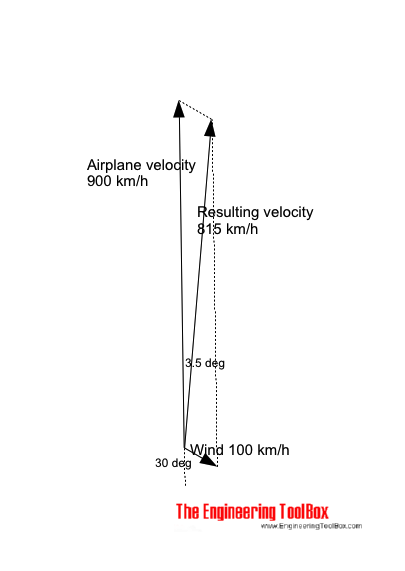

Example - Airplane in Wind
A headwind of 100 km/h is acting 30o starboard on an airplane with velocity 900 km/h.
The resulting velocity for the airplane related to the ground can be calculated as
vR = ((900 km/h)2 + (100 km/h)2 - 2 (900 km/h) (100 km/h) cos(180o - (30o)))1/2
    = 815 (km/h)
The angle between the airplane course and actual relative ground course can be calculated as
 α = sin-1((100 km/h) sin((180o) - (30o)) / (815 km/h))
    = 3.5o
Airplane - wind velocity and relative ground course

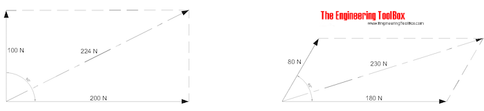

Parallelogram
Resultant vectors can be estimated by drawing parallelograms as indicated below.
Vector addition by drawing parallelograms
  1. draw the vectors with right direction and magnitude
  2. draw parallel lines to the vectors
  3. draw the resultant vector to the crossing point between the parallel lines
  4. measure the magnitude and direction of the resultant vector in the drawing

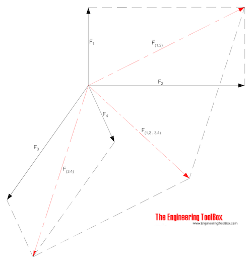

The method can also be used with more than two vectors as indicated below.
Adding multiple vectors - parallelogram
  1. draw the resultant vectors between two and two vectors
  2. draw the resultant vectors between two and two of resultant vectors
  3. continue until there is only one final resultant vector
  4. measure direction and magnitude of the final resultant vector in the drawing
In the example above - first find the resultant F(1,2) by adding F1 and F2, and the resultant F(3,4) by adding F3 and F4. The find the resultant F(1,2.3,4) by adding F(1,2) and F(3,4).
