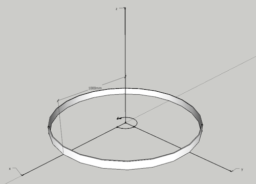

Example - Moment of Inertia of a Single Mass
Moment of inertia
make 3D models with the free Engineering ToolBox Sketchup Extension
The Moment of Inertia with respect to rotation around the z-axis of a single mass of 1 kg distributed as a thin ring as indicated in the figure above, can be calculated as
Iz = (1 kg) ((1000 mm) (0.001 m/mm))2
= 1 kg m2
