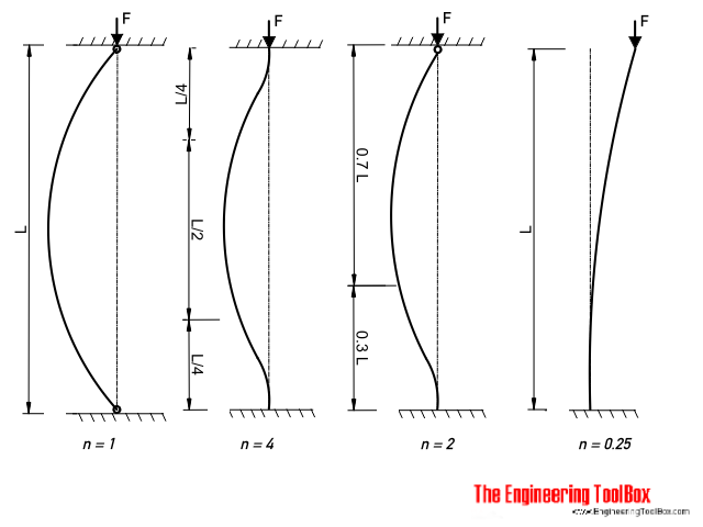

Columns fail by buckling when their critical load is reached. Long columns can be analysed with the Euler column formula
F = n π2 E I / L2                             (1)
F = allowable load (lb, N)
n = factor accounting for the end conditions
E = modulus of elastisity (lb/in2, Pa (N/m2))
L = length of column (in, m)
I = Moment of inertia (in4, m4)
Factor Counting for End Conditions
Euler column - end condition factors and buckling
  • column pivoted in both ends : n = 1
  • both ends fixed : n = 4
  • one end fixed, the other end rounded : n = 2
  • one end fixed, one end free : n = 0.25
Note!
Equation (1) is sometimes expressed with a k factor accounting for the end conditions:
F = π2 E I / (k L)2                             (1b)
k = (1 / n)1/2    factor accounting for the end conditions
n 1 4 2 0.25
k 1 0.5 0.7 2

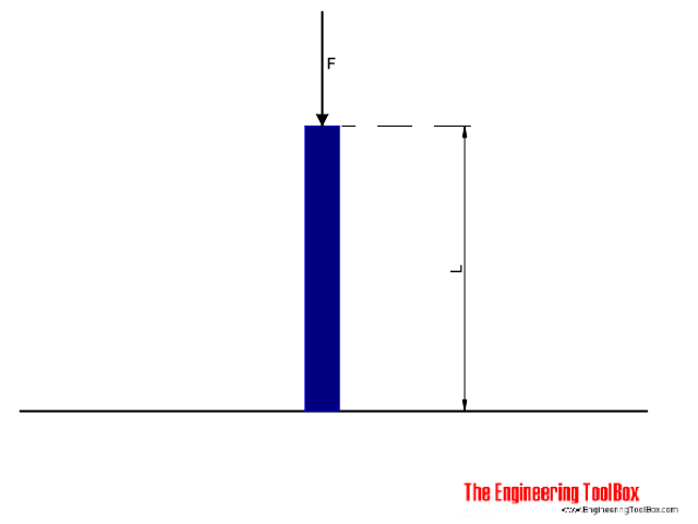

Example - A Column Fixed in both Ends
An column with length 5 m is fixed in both ends. The column is made of an Aluminium I-beam 7 x 4 1/2 x 5.80 with a Moment of Inertia iy = 5.78 in4. The Modulus of Elasticity of aluminum is 69 GPa (69×109 Pa) and the factor for a column fixed in both ends is 4.
The Moment of Inertia can be converted to metric units like
Iy = 5.78 in4 (0.0254 m/in)4
    = 241×10-8  m4
The Euler buckling load can then be calculated as
F = (4) π2 (69×109 Pa) (241×10-8  m4) / (5 m)2
 =  262594 N
 = 263 kN
