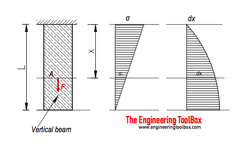

Stress and deformation of vertical beams due to own weight.
Weight of beam - strain, stress and deformation
Axial Force
The axial force acting in a cross sectional area in distance x in a vertical beam due to it's own weight - can be calculated as
Fx = γ  A (L - x)                                    (1)
Fx = axial force in distance x (N)
y = specific weight - unit volume weight (N/m3)
A = cross-sectional area (m2)
L = length of beam (m)
x = distance (m)

Axial Stress
The axial stress at a distance x can be calculated as
σx = Fx / A
    = γ (L - x)
    =  ρ g (L - x)                              (3)

Axial Deformation
The axial deformation at distance x can be calculated as
dxx = y x (2 L - x) / (2 E)
      =   ρ g x (2 L - x) / (2 E)                           (4)
dx = deformation (m)
E = modulus of elasticity (N/m2)

Example - Stress and Axial Deformation of a Vertical Steel Rod
A 45 m long steel rod with density 7280 kg/m3 and cross-sectional area 0.1 m2 is mounted as indicated in the figure above.
The maximum force acting in the rod at distance x = 0 m can be calculated with (1b)
Fx=0  = (7280 kg/m3) (9.81 m/s2) (0.1 m2) ((45 m) - (0 m))
   = 321376 N
   = 321 kN
The maximum axial stress in the rod at distance x = 0 m can be calculated (3b)
σx=0 = (7280 kg/m3) (9.81 m/s2) (45 m)
        = 3213756 N/m2(Pa)
        = 3.2 MPa
The modulus of elasticity for the steel rod is 200 GPa (200×109 N/m2).  The axial deformation at distance x = 45 m can be calculated with (4a)
dxx=45 = (7280 kg/m3) (9.81 m/s2) (45 m)2 / (2 (200×109 N/m2))
       = 0.00036 m
       = 0.4 mm
