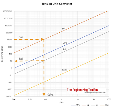

Tension Unit Converter Chart
Download and print Tension Unit Converter Chart
Example - Convert between Tension Units
10000 psi can be converted to 0.069 GPa and 10 ksi as indicated in the chart below:
Tension unit converter chart example
Note! - this online pressure converter can also be used to convert between Tensile Modulus units.
