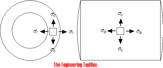

Stress in Thick-Walled Cylinders or Tubes
Radial and tangential stress in thick-walled cylinders or tubes with closed ends - with internal and external pressure.
When a thick-walled tube or cylinder is subjected to internal and external pressure a hoop and longitudinal stress are produced in the wall.
Thick walled cylinder - stress due to pressure
Stress in Axial Direction
The stress in axial direction at a point in the tube or cylinder wall can be expressed as:

Stress in Circumferential Direction - Hoop Stress
The stress in circumferential direction - hoop stress - at a point in the tube or cylinder wall can be expressed as:
σc = ((pi ri2 - po ro2) / (ro2 - ri2)) + (ri2 ro2 (pi - po) / (r2 (ro2 - ri2)))                                    (2)

Stress in Radial Direction
The stress in radial direction at a point in the tube or cylinder wall can be expressed as:
σr = ((pi ri2 - po ro2) / (ro2 - ri2)) - (ri2 ro2 (pi - po) / (r2 (ro2 - ri2)))                                  (3)

Example  - Stress in Thick walled Cylinder
In a cylinder with inside diameter 200 mm (radius 100 mm) and outside diameter 400 mm (radius 200 mm) there is a pressure 100 MPa relative to the outside pressure.
Stress in axial direction can be calculated as
σa = (((100 MPa) (100 mm)2 - (0 MPa) (200 mm)2) / ((200 mm)2 - (100 mm)2
   = 33.3 MPa
Stress in circumferential direction - hoop stress - at the inside wall (100 mm) can be calculated as
σc = (((100 MPa) (100 mm)2 - (0 MPa) (200 mm)2) / ((200 mm)2 - (100 mm)2)) + ((100 mm)2 (200 mm)2 ((0 MPa) - (100 MPa)) / ((100 mm)2 ((200 mm)2 - (100 mm)2)))
    = 167 MPa
Stress in radial direction at the inside wall (100 mm) can be calculated as
σr = (((100 MPa) (100 mm)2 - (0 MPa) (200 mm)2) / ((200 mm)2 - (100 mm)2)) - ((100 mm)2 (200 mm)2 ((0 MPa)- (100 MPa)) / ((100 mm)2 ((200 mm)2 - (100 mm)2)))
    = -100 MPa
