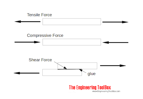

Tensile, compressive and shear force
  • tensile stress - stress that tends to stretch or lengthen the material - acts normal to the stressed area
  • compressive stress - stress that tends to compress or shorten the material - acts normal to the stressed area
  • shearing stress - stress that tends to shear the material - acts in plane to the stressed area at right-angles to compressive or tensile stress

Shear Stress
Stress parallel to a plane is usually denoted as "shear stress" and can be expressed as
τ = Fp / A                               (2)
τ = shear stress (Pa (N/m2), psi (lbf/in2))
Fp = shear force in the plane of the area (N, lbf)
A = area (m2, in2)
A shear force lies in the plane of an area and is developed when external loads tend to cause the two segments of a body to slide over one another.
