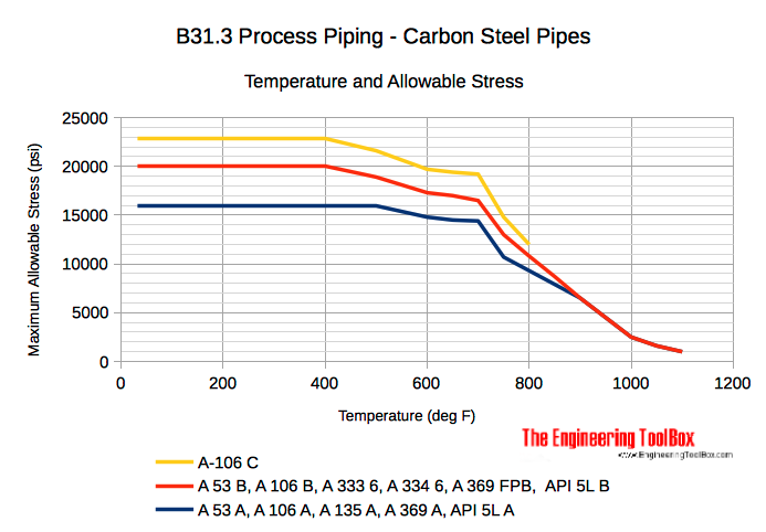

Carbon Steel Pipes and Tubes
  • A 53 Pipe, Steel, Black and Hot-Dipped, Zinc Coated, Welded and Seamless
  • A 106 Seamless Carbon Steel Pipe for High-Temperature Service
  • A 135 Standard Specification for Electric-Resistance-Welded Steel Pipe
  • A 333 Seamless and Welded Steel Pipe for Low-Temperature Service
  • A 334 Seamless and Welded Carbon and Alloy-Steel Tubes for Low-Temperature Service
  • A 369 Standard Specification for Carbon and Ferritic Alloy Steel Forged and Bored Pipe for High-Temperature Service
  • API 5L Line Pipe
Carbon steel pipes - temperature and allowable stress diagram
  • 1 psi (lb/in2) = 6895 Pa (N/m2)
  • 1000 psi = 6.9 MPa
  • T (oC) = 5/9 (T (oF) - 32)
Example - Allowable Stress - 2000 psi vs. MPa
(20000 psi) (6895 Pa/psi) = 137900000 Pa
               = 138 MPa

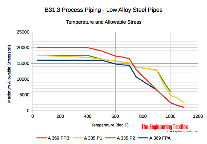

Low and Intermediate Alloy Steel Pipes and Tubes
  • A 335 Seamless Ferritic Alloy Steel Pipe for High-Temperature Service
  • A 369 Carbon Steel and Ferritic Alloy Steel Forged and Bored Pipe for High-Temperature Service
Ferritic alloys steel pipes - temperature and allowable stress diagram

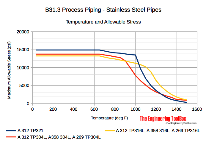

Seamless Austenitic Alloys Steel Pipes
  • A 269 Seamless and Welded Austenitic Stainless Steel Tubing for General Service
  • A 312 Seamless and Welded Austenitic Stainless Steel Pipe
  • A 358 Electric-Fusion-Welded Austenitic Chromium-Nickel Alloy Steel Pipe for High-Temperature Service
Austenitic alloy stainless steel pipes - temperature and allowable stresses diagram
