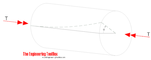

Torsional Deflection of Shaft
Torsion deflection of shaft
The angular deflection of a torsion shaft can be expressed as
α = L T / (JG)                                  (5)
α = angular shaft deflection ( radians)
L = length of shaft (m, ft)
G = Shear Modulus of Rigidity - or Modulus of Rigidity (Pa, psf)
The angular deflection of a torsion solid shaft can be expressed as
α = 32 L T / (G π D4)                             (5a)
The angular deflection of a torsion hollow shaft can be expressed as
α = 32 L T / (G π (D4 - d4))                              (5b)
The angle in degrees can be achieved by multiplying the angle θ in radians with 180 / π.
