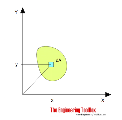

Area Moment of Inertia (Moment of Inertia for an Area or Second Moment of Area)
Area Moment of Inertia - Moment of Inertia for an Area - Second Moment of Area
for bending around the x axis can be expressed as
Ix = ∫ y2 dA                          (1)
Ix = Area Moment of Inertia related to the x axis (m4, mm4, inches4)
y = the perpendicular distance from axis x to the element dA (m, mm, inches)
dA = an elemental area (m2, mm2, inches2)
The Moment of Inertia for bending around the y axis can be expressed as
Iy = ∫ x2 dA                          (2)
Iy = Area Moment of Inertia related to the y axis (m4, mm4, inches4)
x = the perpendicular distance from axis y to the element dA (m, mm, inches)

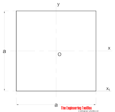

Solid Square Cross Section
Area moment of inertia - Square section
The Area Moment of Inertia for a solid square section can be calculated as
Ix = a4 / 12                        (2)
a = side (mm, m, in..)
Iy = a4 / 12                         (2b)

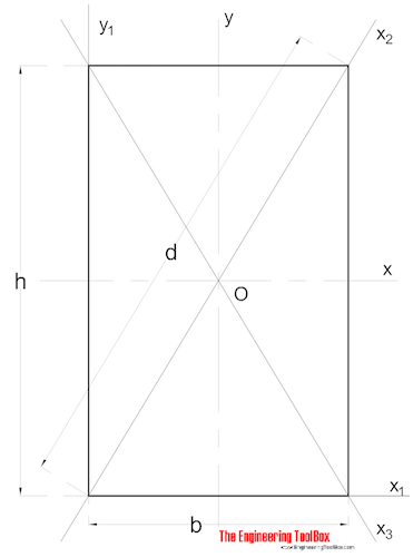

Solid Rectangular Cross Section
Area moment of inertia - rectangular section
The Area Moment of Ineria for a rectangular section can be calculated as
Ix = b h3 / 12                          (3)
b = width
h = height
Iy = b3 h / 12                           (3b)

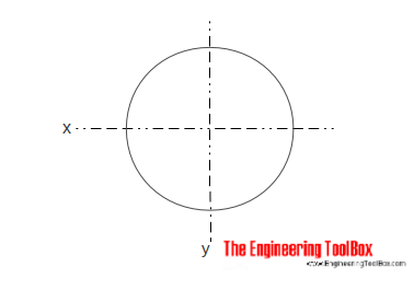

Solid Circular Cross Section
Area moment of inertia - circular section
The Area Moment of Inertia for a solid cylindrical section can be calculated as
Ix = π r4 / 4
    = π d4 / 64                            (4)
r = radius
d = diameter
Iy = π r4 / 4
    = π d4 / 64                             (4b)

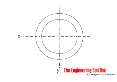

Hollow Cylindrical Cross Section
Area moment of inertia - cylindrical section
The Area Moment of Inertia for a hollow cylindrical section can be calculated as
Ix = π (do4 - di4) / 64                            (5)
do = cylinder outside diameter
di = cylinder inside diameter
Iy = π (do4 - di4) / 64                          (5b)

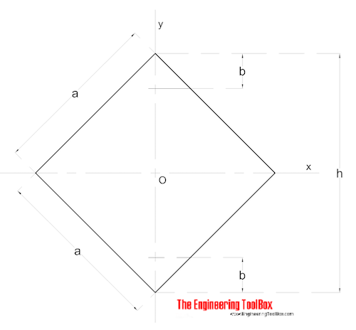

Square Section - Diagonal Moments
Square - Diagonal Area Moments of Inertia
The diagonal Area Moments of Inertia for a square section can be calculated as
Ix = Iy = a4 / 12                   (6)

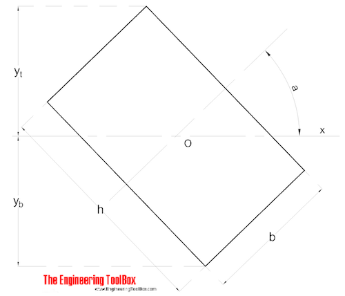

Rectangular Section - Area Moments on any line through Center of Gravity
Area Moment of Inertia through Center of Gravity for Rectangular Section
Rectangular section and Area of Moment on line through Center of Gravity can be calculated as
Ix = (b h / 12) (h2 cos2(a) + b2 sin2(a))                  (7)

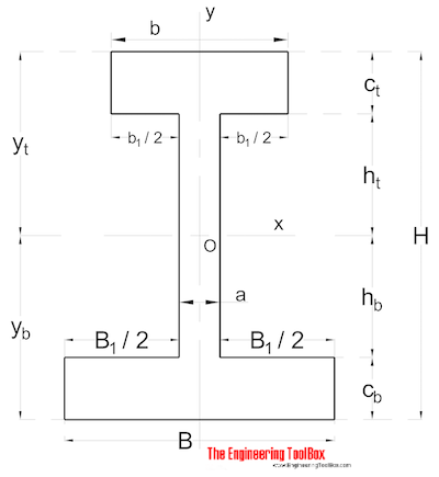

Nonsymmetrical Shape
Area Moment of Inertia - Nonsymetrical Shape
Area Moment of Inertia for a non symmetrical shaped section can be calculated as
Ix = 1/3 (B yb3 - B1 hb3 + b yt3 - b1 ht3)                       (9)
