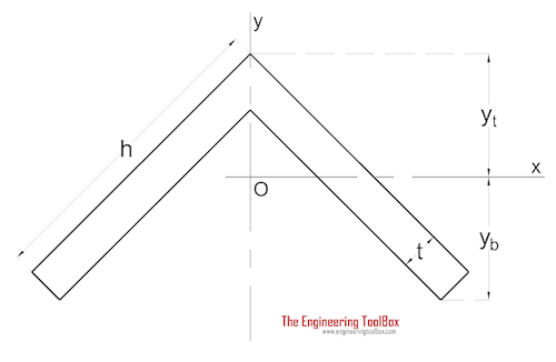

Angle with Equal Legs
Area moment of inertia - Angle with Equal Legs
The Area Moment of Inertia for an angle with equal legs can be calculated as
Ix = 1/3 (2 c4 - 2 (c - t)4 + t (h - 2 c + 1/2 t)3)                       (1a)
c = yt cos(45o)                             (1b)
and
yt = (h2 + ht + t2) / (2 (2 h - t) cos(45o))                               (1c)

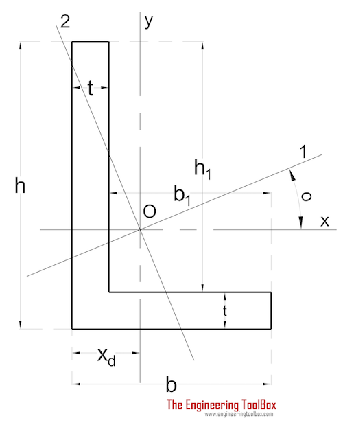

Angle with Unequal Legs
Area moment of inertia - Angle with Unequal Legs
The Area Moment of Inertia for an angle with unequal legs can be calculated as
Ix = 1/3 (t (h - yd)3 + b yd3 - b1 (yd - t)3)                            (2a)
Iy = 1/3 (t (b - xd)3 + h xd3 - h1 (xd - t)3)                            (2b)
xd = (b2 + h1 t) / (2 (b + h1))                                 (2c)
yd = (h2 + b1 t) / (2 (h + b1))

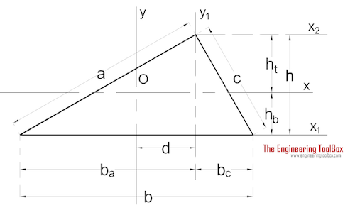

Triangle
Area moment of inertia - Triangle
The Area Moment of Inertia for a triangle can be calculated as
Ix =  b h3 / 36                                (3a)
Iy = h b (b2 - ba bc) / 36                         (3b)

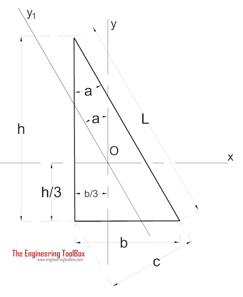

Rectangular Triangle
Area moment of inertia - Rectangular Triangle
The Area Moment of Inertia for a rectangular triangle can be calculated as
Ix =  b h3 / 36                                (4a)
Iy =h b3 / 36                              (4b)
